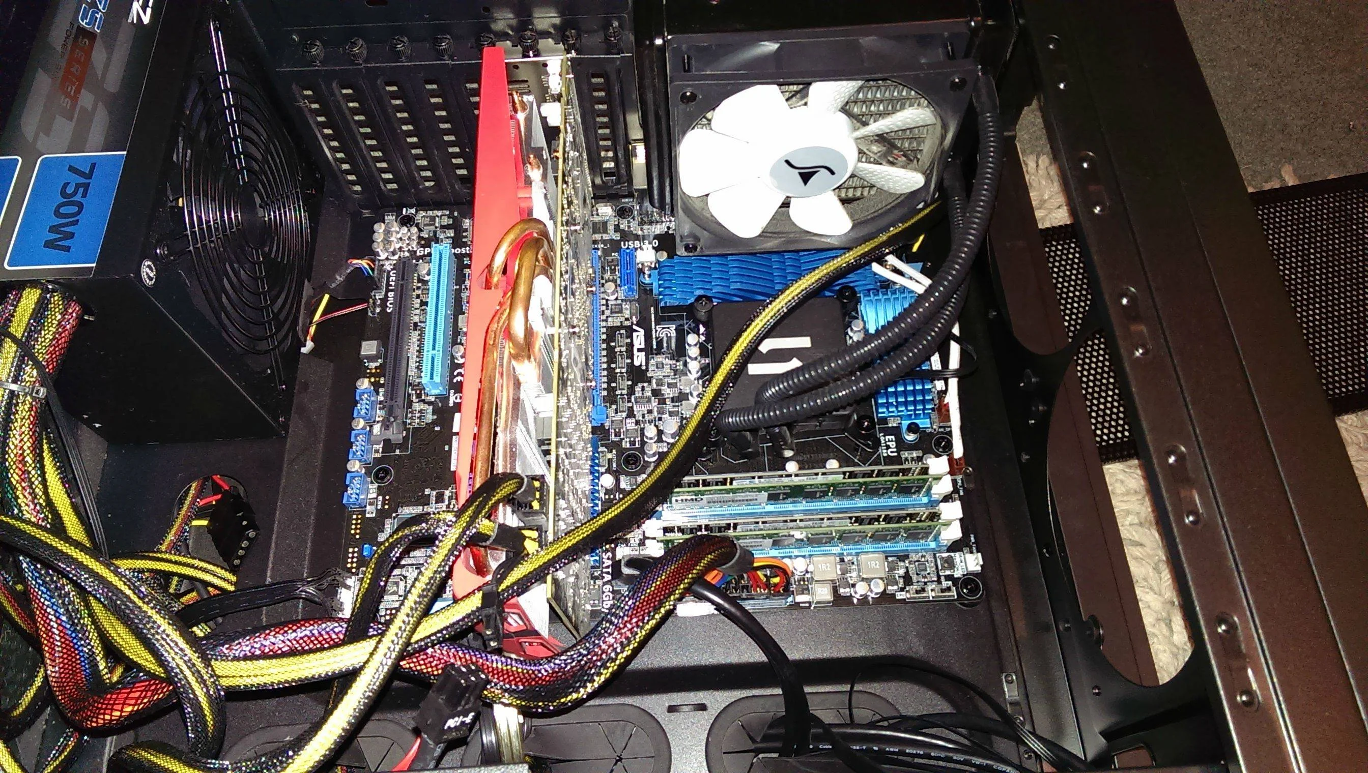

It's the case header, nothing untoward.
Edit: Saying that, maybe the on button is disconnected but I don't think it is, it's normally on the bottom row.
I was just curious why they aren't all plugged in. All the machines I've fixed/built have had the headers plugged in?
Thats pretty much normal if using the ASUS Quick Block :)
Is the "Quick Block" the Q Connector? If so, it doesn't look as if there is one there?

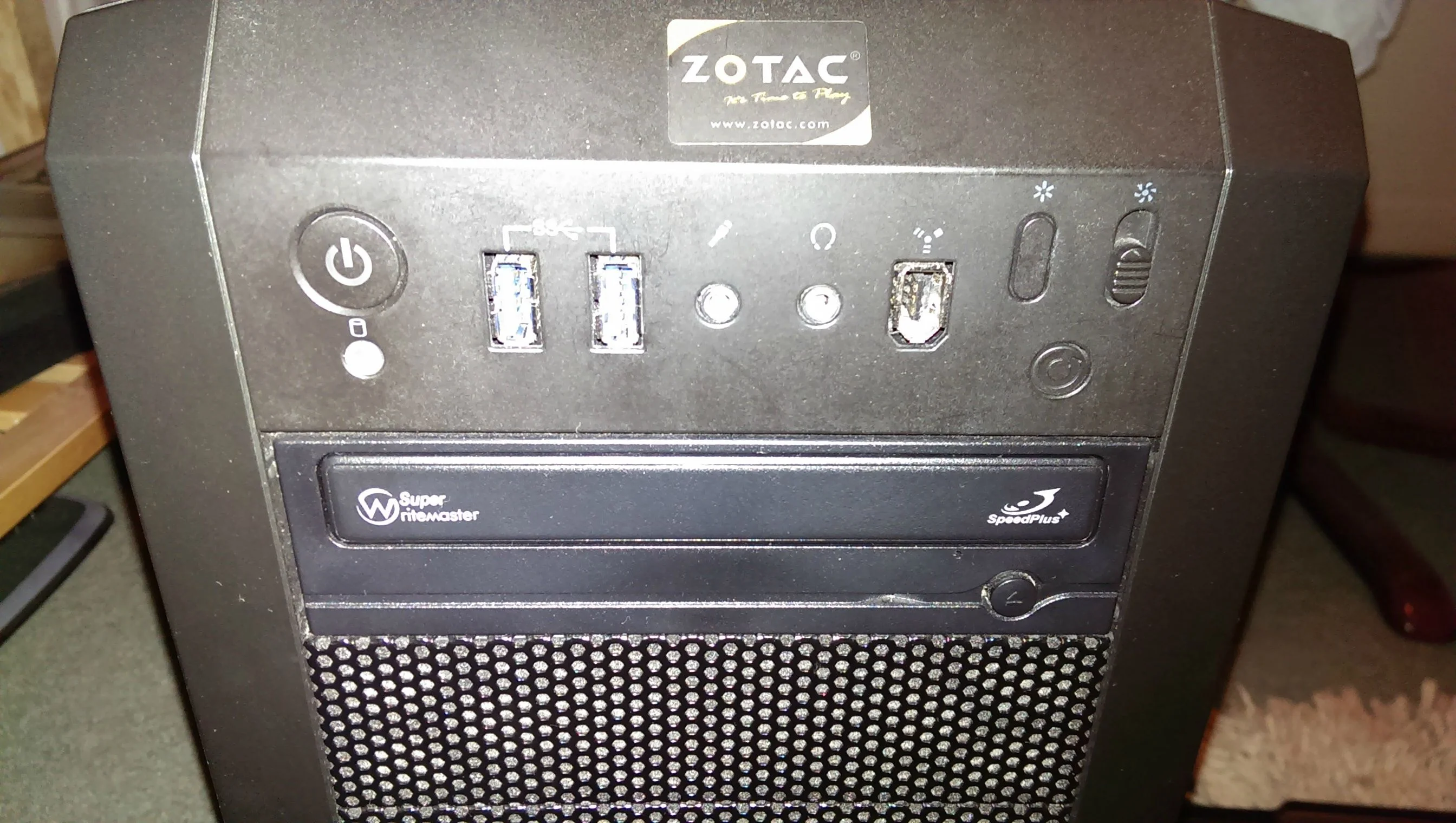

that has nothing to do with the power supply,the board or anything else has not been touched
ofc it has to do with the psu
the power from the psu goes into the mobo and powers the front panel on the
pc case if the power button is connected up wrong you will get no power
maybe a quick power on and off
My guess is when you fitted new PSU and when you was shoving the cables in the gap
under the board you knocked the front panel wires out and put them back in and didnt get
them right
But i thought you fitted the new PSU and that didnt work aswell ?
You could be unlucky and have 2 faulty PSU's can happen or you have missed something when fitting new PSU

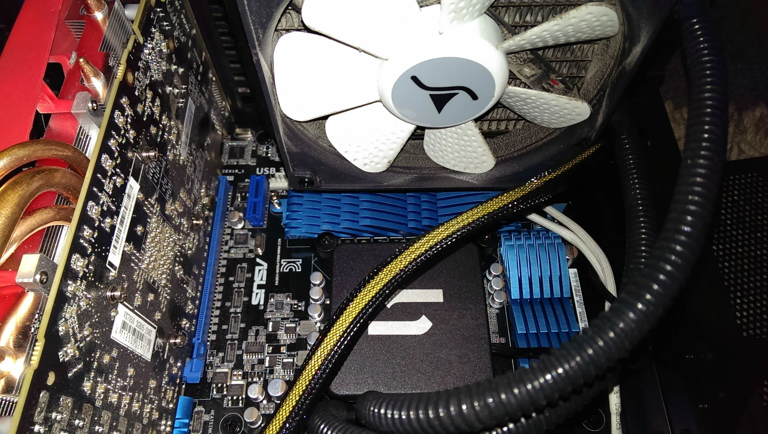

The company that you have sent the PC to for repair are talking rubbish the fan cable shown in the picture is standard practice. The only way the CPU would overheat would be of the cooler completely failed. The other possible cause would be if the cooler and blown or possibly leaked and taken the card out too.
Just to clarify this is not a build fault definitely not after 18 months and just a standard hardware failure.

Is the 20+4pin connector inserted fully? It looks like the edge of the 20 pin is catching on the edge of the +4 pin?
