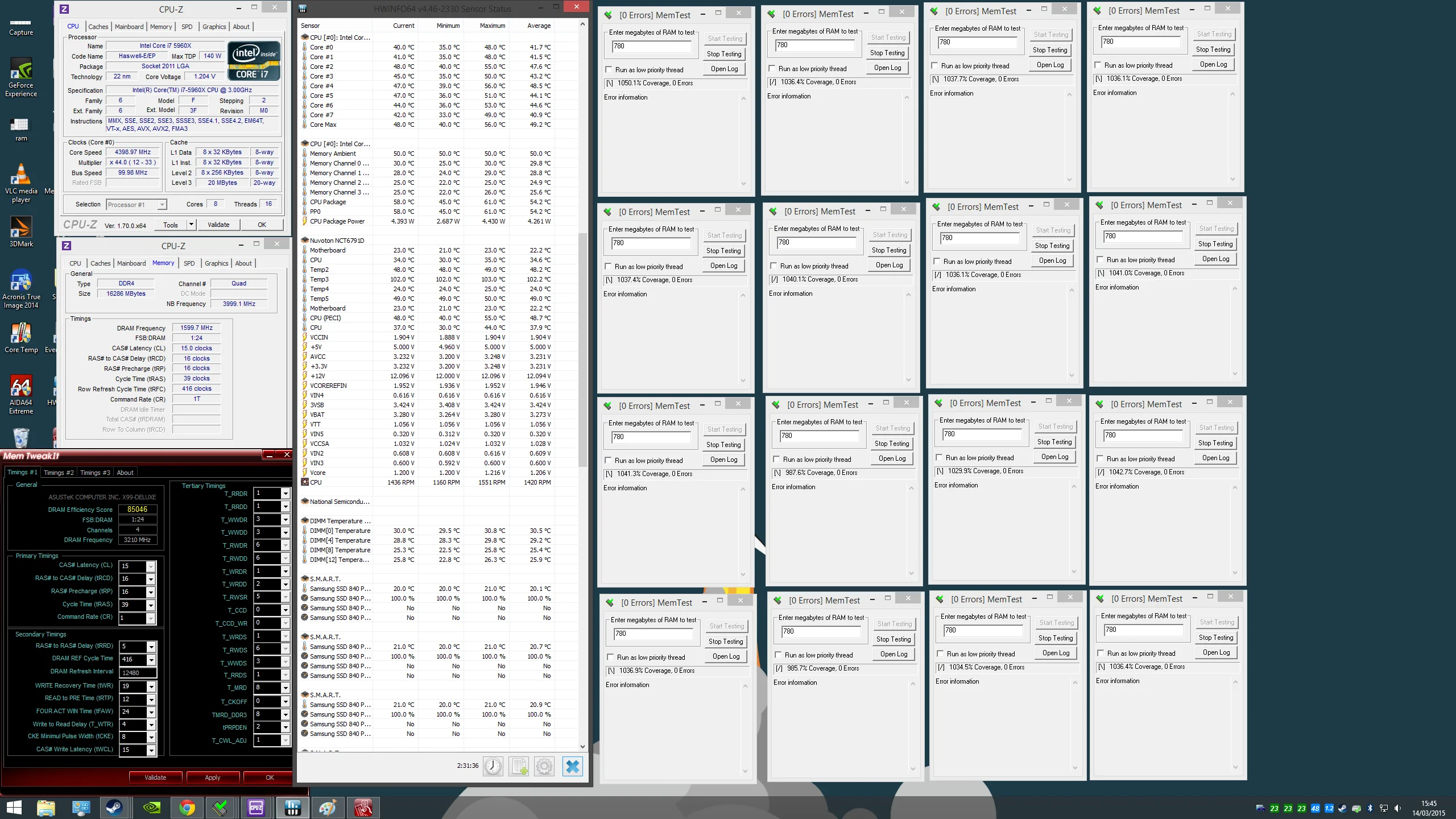

Working on 3200 ratio with the 3000 Hyper X kit (cheapest 3000 kit on the market)
