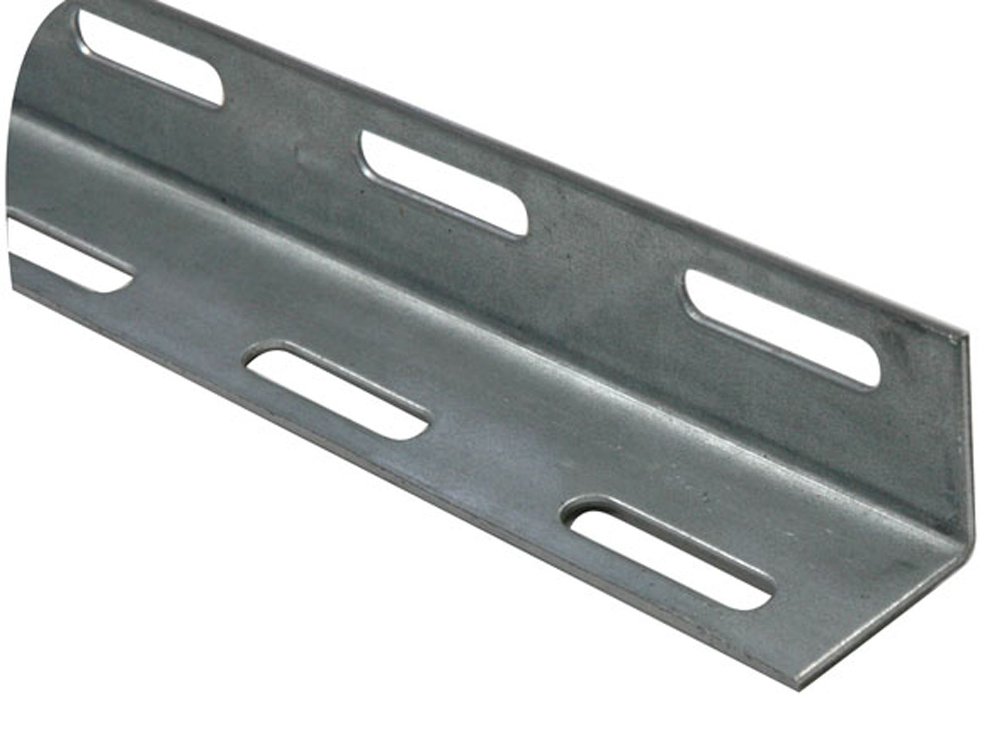

Angle steel, both B and Q and Wickes should stock them.
First thing I would try is to screw something like this along the back edge of the gap:
Assuming the worktop is the 38mm thickness version.

It would cover most of it, so should give the support it requires. As I said it would be the first thing I would try and go from there, however I would be suprised if it still requires more support after that.
Yes, pilot some holes with a small drill bit (the drill bit needs to be thinner than the shank of the screw), then screw in, perhaps 4 under and 4 at the back. Shouldn't need washers.

Not to the wall no, to the back edge of the desk. So that the L profile is 'hugging' it.

Screwing into the back would offer more support, and you can use longer screws. If the back part is well supported and doesn't sag the front shouldn't.
