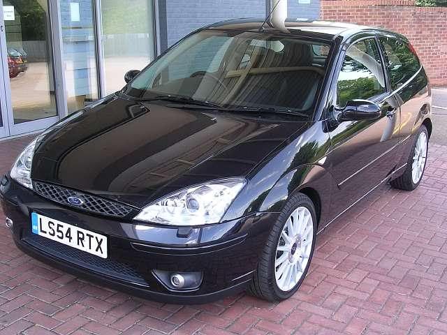

First off, that HID light shot taken from the Focus looks Rubbish, the non flat cuttoff at the top just goes to prove how bad these cheap kits are then compounded by the fact you're not fitting them to projector lenses.
