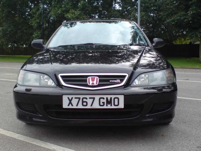

My dads R34 & Bro in laws accord Type R had xenons fitted as standard @ the factory without projectors. Infact a lot of Jap cars do without projectors. Whats the difference here then?
I thought both Accord Type R and R34 with Xenons had projectors? Can't say I've seen that many R34's but Accords certainly have projectors - you dont get factory fit HID systems without projector lenses.
Maybe I am misunderstanding projectors then. Is this the projector both cars of which I mentioned do not have this.
Yes, thats a projector. But Psycrow owned an ATR with HID's and had projectors, and you can't sell cars in the UK with HID's which don't have projectors.
Not all Accord Type R's had HID's either just what do you expect to prove with random pictures of cars? I could show you a Focus ST with reflector lights even though you know very well the HID models had projectors.

I am telling you 100% that not all cars with xenons from the factory have projectors ....accept it :)
http://www.accordr.org/index.php?showtopic=13455&hl=xenon
Car has the standard Accord Type-R Spec:
2001 facelift

Xenon HID Headlights

Now anyone know how they sort out the alignment without a projector?

To be honest I never really poked around to see if the ATR had projectors, I just assumed they did since a legal requirement. When you fired the lights up they formed a perfect line beam that auto levels, the HID kit on my accord sport threw light all over the shop - So it wasn't the same reflectors as the standard accord.

My Estima has factory Xenons, but doesn't have projectors :)
It has a kind of 'mask' over the top half of the bulbs though, and I'd guess the reflectors are designed in a different way to those used with normal bulbs.
