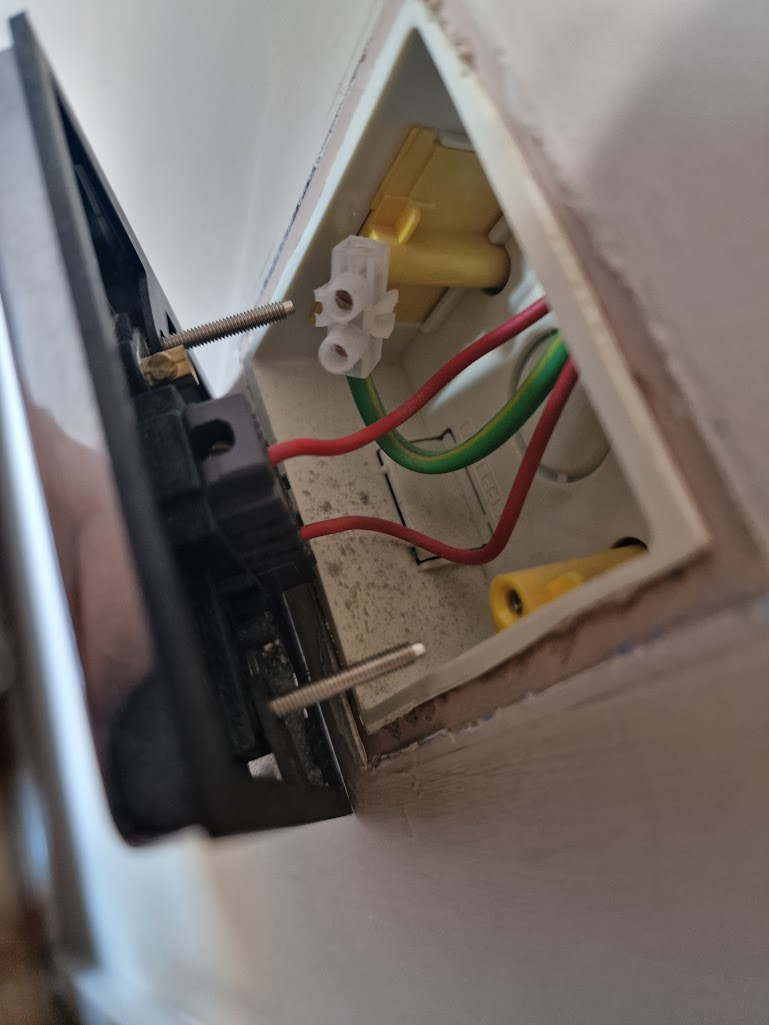

No neutral wire :/

Cool, just got one delivered. Shoudl hopefully work with my hue hub (latest version)You can get smart modules that don't need a neutral.
https://amzn.eu/d/j2wLzoY
You'll need a Zigbee hub to connect it to HA.
There might be a problem fitting in in the back box, but you can pop out the yellow tabs and look behind the box to see if there's space for you to fit a deeper one.
Make sure you turn off the correct circuit at your consumer unit first!
