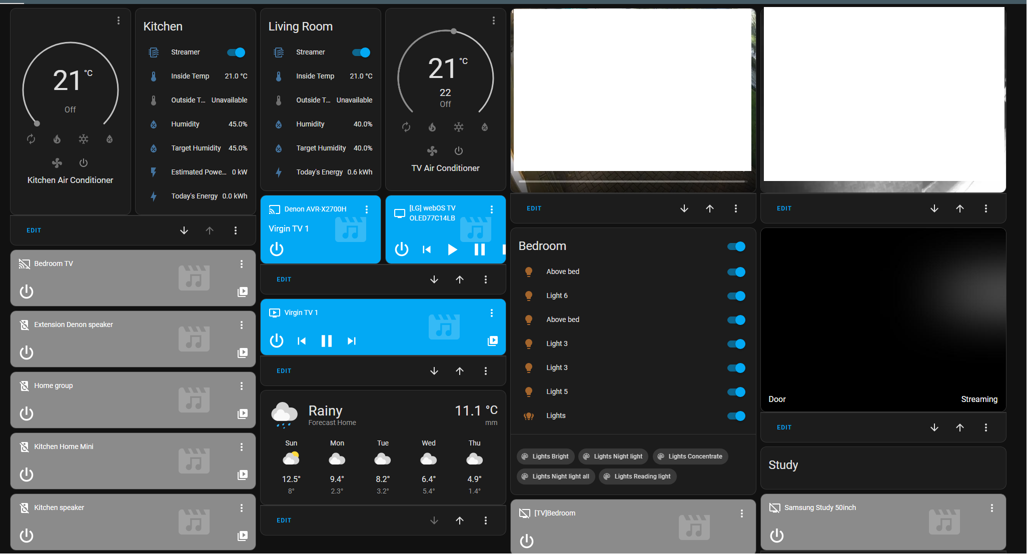

Do most of you stick with the default dashboard?
I have 2 RTSP camera feeds on there I'd like to make bigger, but I can't with the default :( and the up and down method of moving stuff is kinda sucky as well

Yeah, but the card sizes i mean e.g.
The white boxes are camera streams. I want them to be bigger, maybe two cards wide and high. Is that possible?
The tutorials etc I've watched don't show resizing cards :(
Yeah, this is more about web design than HA (ie same in Bootstrap, Material and so on).
You can set to panel:true for a full screen CCTV or for two columns as you describe, look at the grid card instructions/examples.
You've got four columns and it's stretching to max size (which is naturally the size it's got already!)
