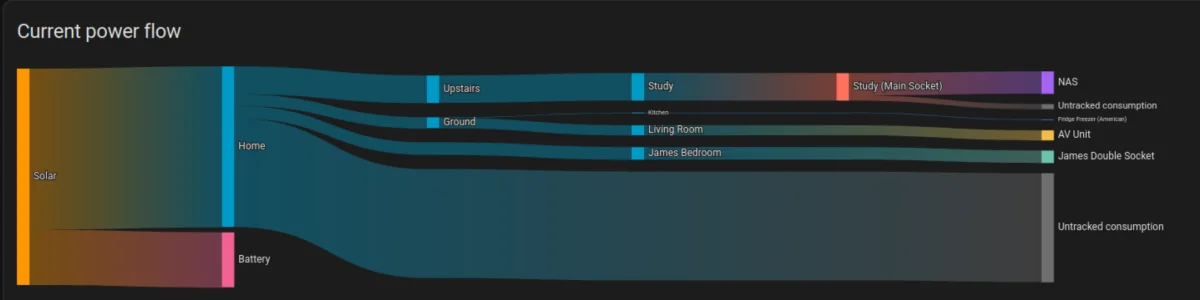

@Demon is that a HA extension to show energy flows or something else ?
That's just the built in energy dashboard, when you configure it, you can add power draw entities towards the bottom of the config page and they pop up on the dashboard.

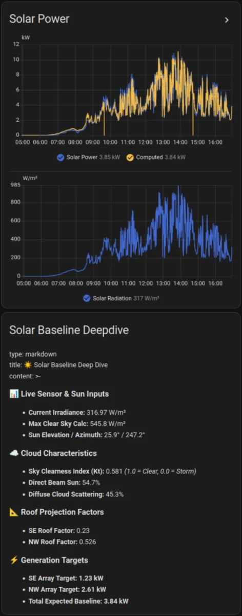

I've been building a solar 'baseline' based on my weather stations solar radiation value, the station is mount above the apex on the gable end, so above the panels.. AI helped with the Algo, but its been so stupid at times, you really have to lead it by the nose..
However, it's getting more accurate, my actual generation lags in low light a bit, and it does spike through cloud edge phenomena, but by and large it seems to be tracking the theory fairly well:
The two values (weather station and powerwall 3 reported generation) are slightly out of sync, but like for like within .2kw generally and I've just upped the efficiency value to a theoretical maximum of 95% efficient from panel, through the cabling and losses in the MPPT to the report value..

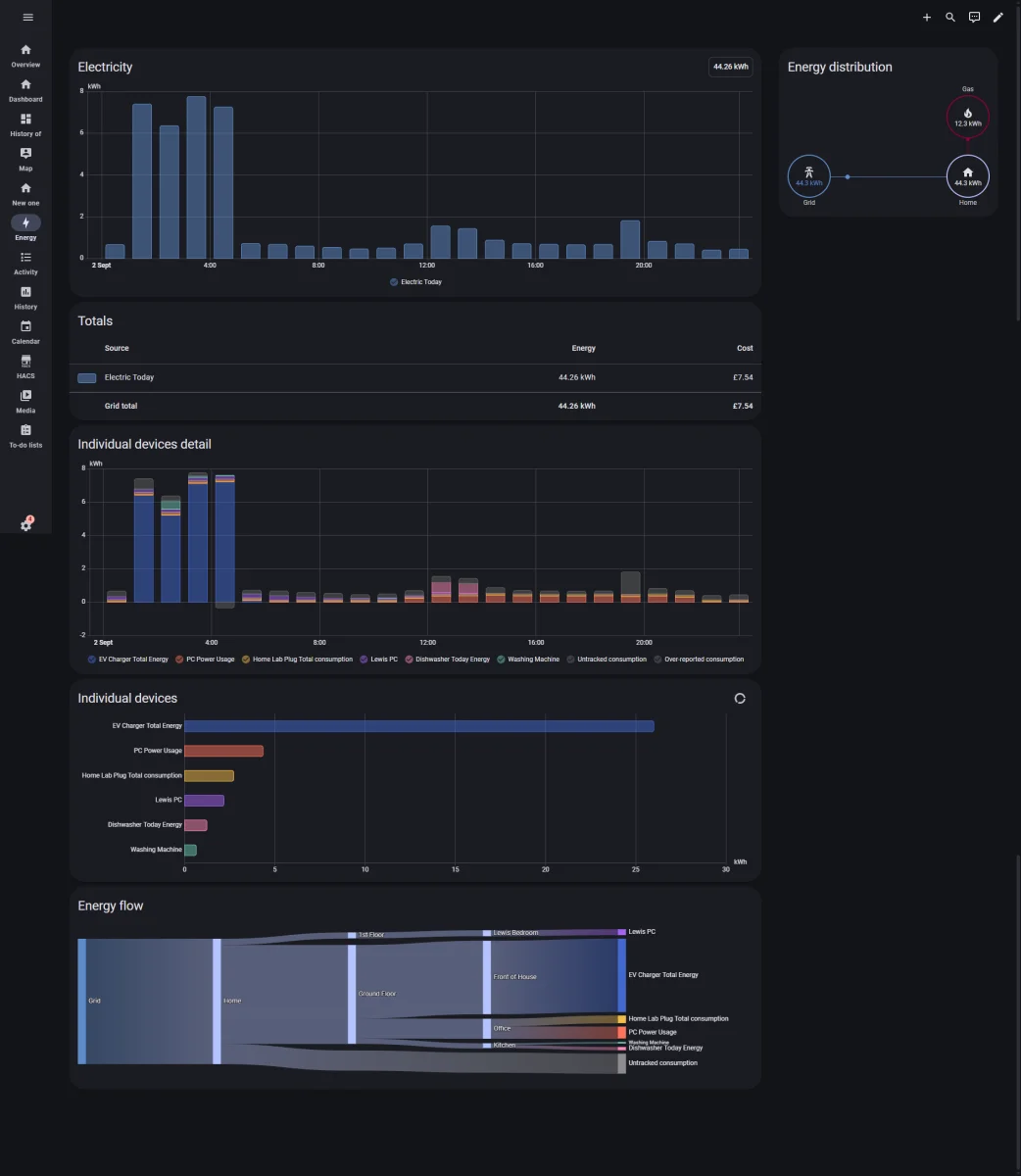

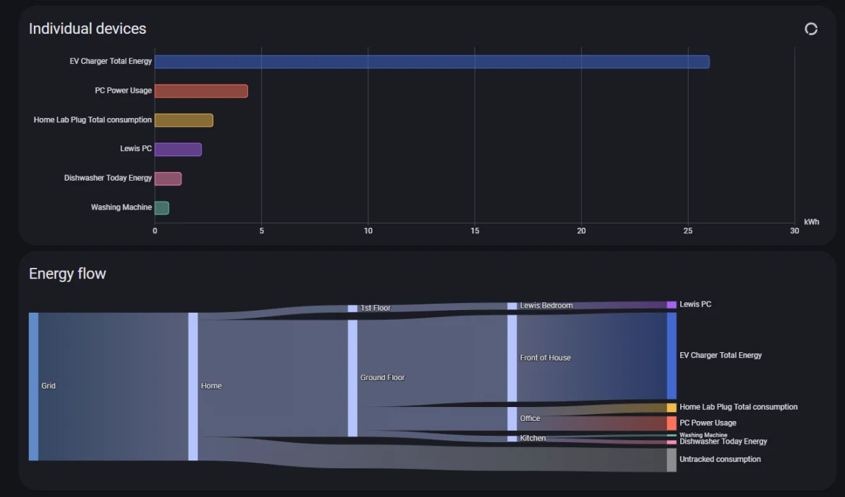

This was my power use yesterday, quite good info. I need to add my TV in the living room, my oven, my airfryer & Toaster, maybe even the fridge-freezer and the bedroom TV. Think that will be 99% of stuff.

I've refined my solar model, it's just including anistropic cloud weighting: It's still not perfect, as in reality its 24C and the panels will be much hotter, so that inefficiency is not factored in properly yet.
Certainly it's given me confidence the newly installed array(s) are working as expected..

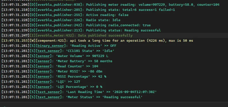

I programmed this to read my water meter radio signal. After flashing the ESP32 and banging my head against a wall trying to get it to read the radio signal from my meter. I finally found out that my particular meter will be setup to only reply to radio signal requests between 9am and 5pm. I was trying at 8pm... The water board do this to save battery life.
So tomorrow I need to try again.
yes 433.8 is the meter. the coding I flashed was as follows. I used the ESP Home Device Builder to write the YAML code to flash it.

Could you do OCR to read it?
I guess if you have a compatible 433mhz radio receiver, then don't see why not.
Once I test it tomorrow during the day hours, and it picks up a signal and logs it in home assist I can then start designing a little box to 3dprint so its enclosed. The other thing I tried tonight was connect the ESP to a power bank, but that doesn't work, because the ESP power draw is so little when initialising the power bank doesnt enable the power draw, so it doesn't work. Had to connect it in a mains socket USB instead.

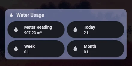

So the main reason I'm hell bent on getting a log for water usage is because I found out my toilet was leaking water 24/7 into the bowl from the cistern, for god knows how long, but the average daily water use last water bill was 842 litres of water PER day! (3 bed house with only me, my wife and our adult son) As you can image, it's rather excessive - it actually took a while to realise there was a gentle yet silent continual stream of water leaking into the bowl for the toilet. Got that fixed now anyway. But want a means to be able to monitor it.
