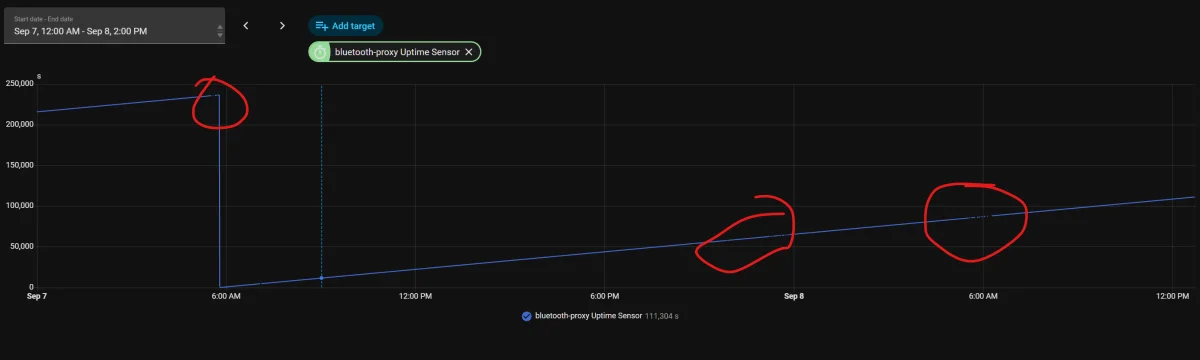

This is the kind of dependency bought into the chain that I'm trying to avoid, have you ever monitored the uptime of an esp32 ?
The whole point from my original post is to have a rock solid 24/7 solution without any breaks in service
Can't say I've ever monitored the uptime of an ESP32 but equally I've not had the need to. That said, I just checked mine and they're showing as up since they were updated to ESPHome 2026.8.2 other the one that I pulled the cable for in error.
