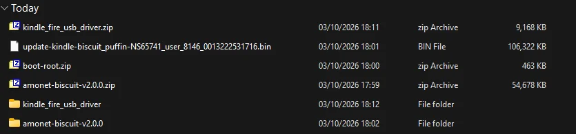

Just got back from chores and thought I'd give it a try.
Using windows I needed the kindle driver
Files

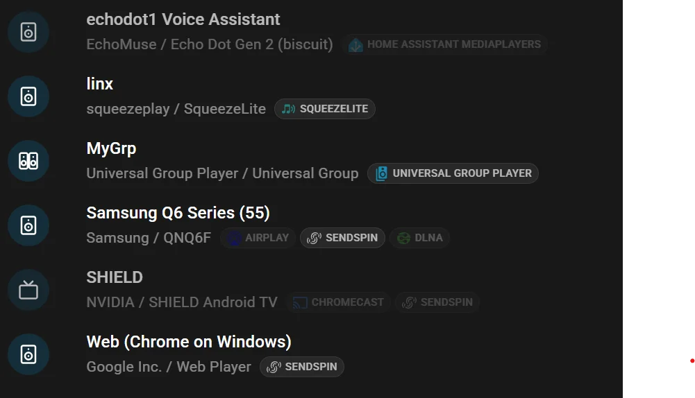

Amazing.... Adopted into Home Assistant.... Now I can get rid of that crappy Amazon echo integration that keeps breaking
I wonder if I can also install other software or do a chroot
Looks quite straight forward. I’m a bit gutted I’ve no 2nd gen Echos now.
Looks like they can be had on the bay for 15 quid which is a bargain considering what you're getting
- a decent HA voice assistant and media player for music assistant
..... and the main reason for doing this ?
COMPLETELY LOCAL
No more calling Amazon home or Jeff Bezos
I don't see a single call outside of my network. To make it 100% I can ban it from the internet too

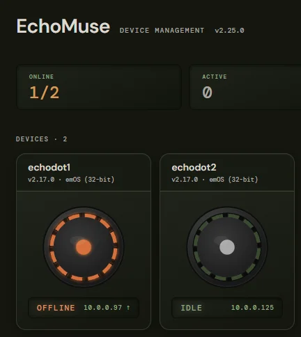

Second echo added to the fleet
I'm going to stick to the stable release 2.17 ... 2.18 with SendSpin support is literally days or a week away
So to summarise, features EchoMuse gives you and HA
- Local Voice assistant
- Media player support via Home assistant (Music Assistant SendSpin support coming very soon)
- Bluetooth proxy (untested, this could be very useful)
If you could also pair BT speakers and pass them through to HA as a SendSpin device instead of being a BT proxy that would be amazing
