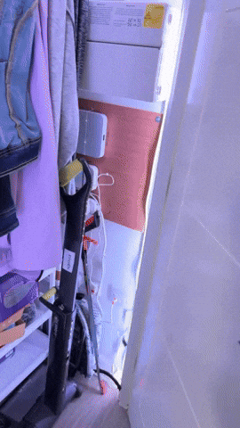

Understairs Govee LED strip controlled by contact sensor.
I couldn't get it to do local control, I'm having to use a HACS add-on and the cloud
