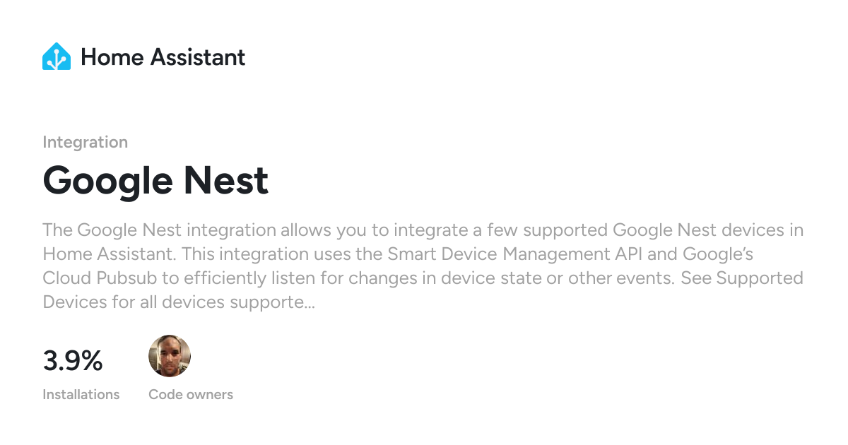

Well I tried adding my nest door bell... needless to say my mind was somewhat blown at it! I might need a bit more coffee / time to work it out! :D
Yes... that's what blew my mind! hence the need for coffee. but it's 1hr past my bed time. The kids were asleep, the wife was out, so I thought... hmmm, time for some HA work! :D
Not sure it's coffee you need... Something stronger... ;)
You can either just go into HA > Integrations > Add integration
Or you can click the 'Add Integration' on the above link?
That's pretty much it
I did all the developer cloud thingies I needed to do which made my head hurt. I had to create so many different "entities" on google and APIs and so on and OAuth things... It's way too late!
Ah right, fair point - that's Google being asses, you only need to do that once, but is a bit of a nerd fest!
One for fresh eyes!
