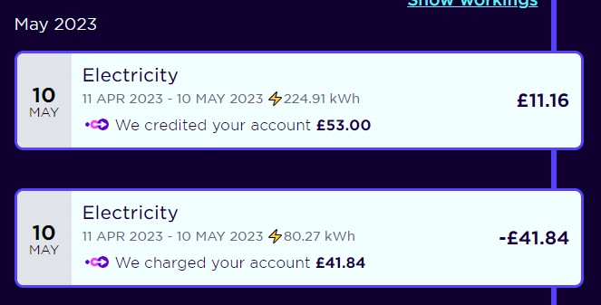

So my previous credit of £8 up until the end of April has now disappeared and I have no flux export as Octopus are looking into it. The sage continues. Should be due about £100 or so by my calculations...
This is what I said though you can't do daily manual reads for Flux exporting, as it's reliant on 30 min values and varies in the day.
Some of the smart meters do store data though, so it may be that your historical info is available.
Yeah indeed, but they said it was connected and on the flux export twrriff, it's doing import fine, will just be moaning as I've done a lot of peak exporting since been on it.
You should have some data from your grid out on the inverter to support figures at least, but find out if the smart meter data includes it.
They may have it.
Sigh had my bill through today after first month on flux and similar to yourself all export missing... Billed me £66 but expected to be about £4 in credit (octopus watch)
Got in touch and they've said a half hourly read is missing..
