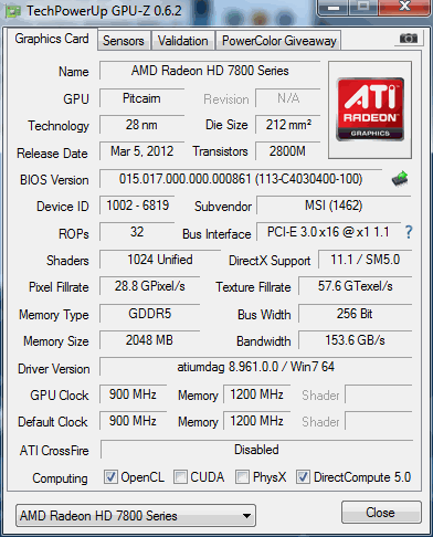

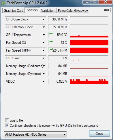

Well got home from work to find my Msi 7850 frozr III had turned up, Thought it best to do a fresh install of win7. After installing all the mobo drivers etc, I then set about seeing what the Msi is like, At the moment everything is at stock Msi setting and after running heaven bench once I gotta say that I was unimpressed with the temps on this card, I thought it would run cooler than 59c on load...Is it me or is that not a little high for a frozr 3?
My old frozr 2 460 was cooler at load @ 53c...Am I missing something here or are those temps normal for the card? Here are the links to the gpuz screens, Any help would be appreciated...Thanks!

Edit: My ASIC quality is 78.8%......What does this mean??
59degrees is cool. These cards are okay up to 85. ASIC Quality is an "indication" of how good the GPU silicon is. Higher generally equals better, but it is not as simple as that. My 84.9% is lower than many others, but so far nobody can come close to my overclocks. A higher number increases the odds of a good overclock, but it does not guarantee it. Likewise, a low number does not necessarily result in a bad clocker.

Cheers 555BUK, After checking out some reviews it seems my card is just under stock temps by 4-5c, Given that my card has a factory O/C on it makes it about right! That will do for me, Gonna try for a bit of O/cing now that my mind is at rest!! :D:D

looking at those screenshots the fan only reached 40 odd percent and hit 59c,have you tried manually setting fan speed? how loud is it above 50%? try higher and it will improve load temps

At 50% It is quite audible, As it is now is fine I am @ 1000 gpu clock and @ 4900 mem, The temp still only tops out at 59c....Gonna try and get this to 1200 with-out too much of a bump in volts..:)
