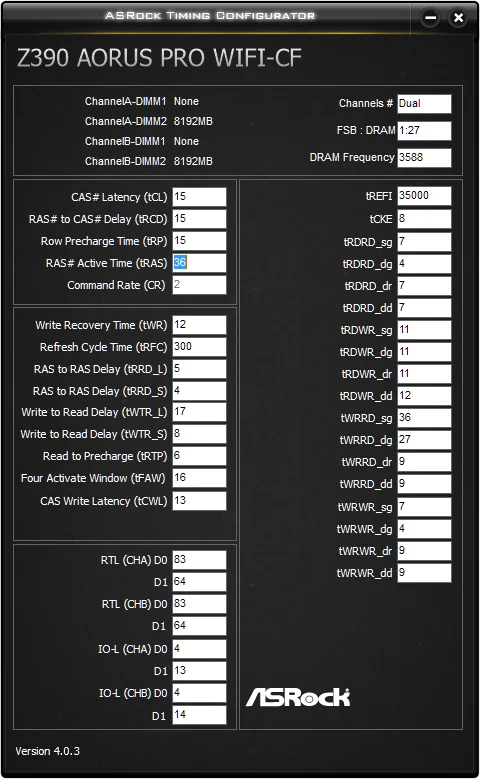

My timings are below. Let me know if have any recommendations to tune them further.
On my board changing "tWTR_S/L" don't get trained and stay at 8/17 regardless of what I put in there :(
