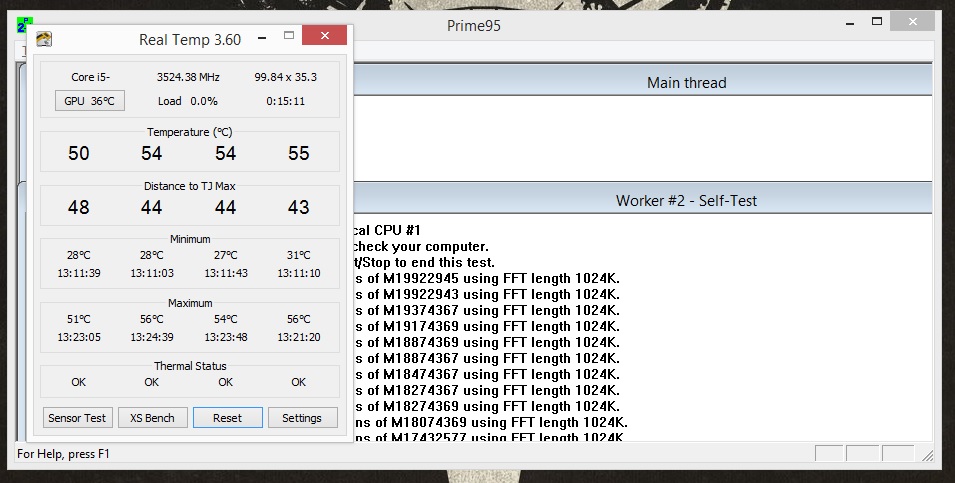

4670k under a phanteks PH-TC14PE.
MX4 = idle 25c
ICD = idle 26c
MX4 =LOAD 63c
ICD = LOAD 60c
Not bad a 3c drop over MX4. Real bench was used to stress test for one hour.

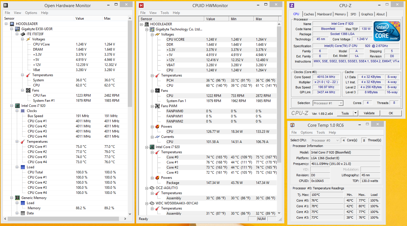

Hardware:
i7 920
cooler:
ASUS triton 88
Stressed with Prime 95
Old asus bundled paste
Ambient:23
CPU Idle: 37
CPU Load: 80 (eek!)
ICD:
Ambient:21
CPU Idle: 38
CPU Load: 73

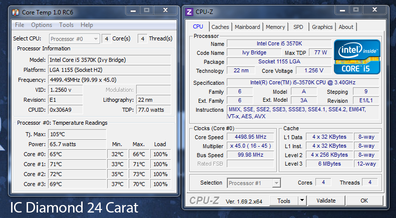

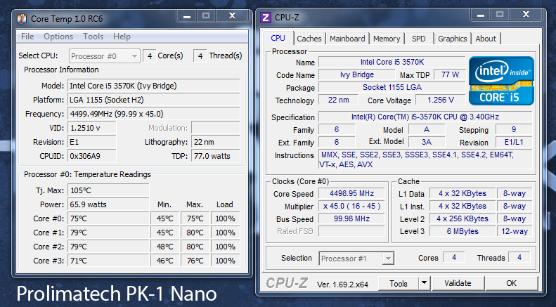

i5 3570k @ 4.00ghz
Picture on left is of the Artic Silver 5 paste. On the right is the IC-Diamong 24. Ran prime for 7mins on each test (quick test)
Knocked a few degrees off the idle temps, though the loads are slightly higher, may try reapply the IC-Diamond again when get the chance as not entirely happy with how the block is sitting on top. But overall happy with the idle temps :)
