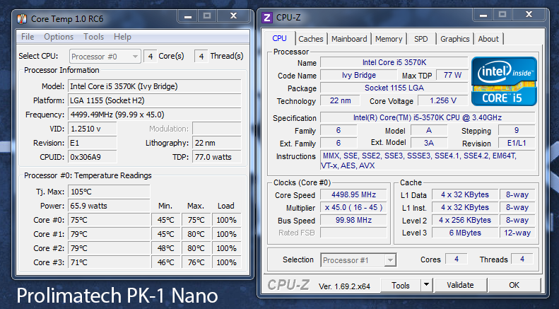

Here are my CPU results:
- 3570k @ 4.5GHz, 1.25v
- GTX 770
- Fractal Define R3
- TRUE Cooler + Scythe Gentle Typhoon
Ambient temps for both results: 23.5c
Before:
Old paste, probably not in best condition at this point and needed reapplying.
After
Followed instructions (small pearl in middle)
Conclusions:
Apologies for forgetting to do idle temps, imo they are not very important to see anyway. At load using Prime95, the new paste knocked off roughly 6-7c over all the cores - big results, and this is directly after install. Will likely do my GTX770 in the next few days, too. Thanks to Frostdragon for sending the paste!

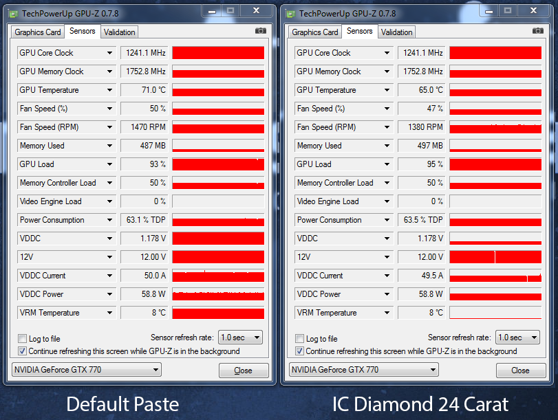

My CPU result is a few posts above, now for my GPU:
MSI Lightening GTX770 Results
Ambient temp: 24.1c for both tests
The GTX770 had the factory default paste, never touched. Removed heatsink and added a pearl of IC Diamond on the core. Took all of 5 minutes on this card.
Results for idle on stock was 38c, with IC diamond, 35c.
Load:
That's 6c knocked off with the IC Diamond paste. Honestly, this paste rocks. Also note, due to the temps being lower, the fan rpm slowed from 1470rpm to 1380rpm, which makes it marginally more impressive, still, as technically it had less airflow.
This will be my "go to" paste from now on. I was dubious as to how much this paste would improve temps, but the drops on both my CPU and GPU are significant.

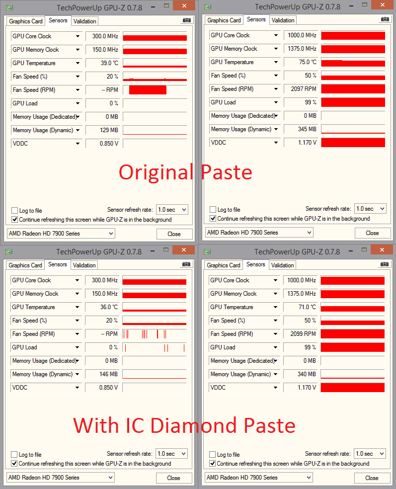

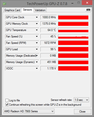

So ran over 2 machines, a basic i3-330m laptop and a desktop with a 4670k cooled with a H60 and two gigabyte windforce 7970s in crossfire. Have done before and after temps, the ambient temp was kept at 22 degrees via an air con
results of 4570k on a h60 with stock paste
i3-330m Sony vaio laptop
7970 Windforce 3x
Some good looking results there, all dropped which is good!
*update* after leaving the furmark and prime running for a few hours this is the result! A HUGE 10 degree drop now on gpu and 4670k idle down to 28!! So this definatly looks like you need to leave it running hot for a while to let it set in.

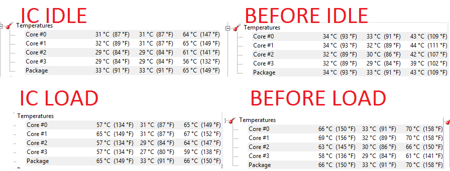

Ok finally found time reapply the TIM.
Idle Temps
Load Temps
Before / After
The load temps were measured using BF4 Test Range, flying around for exactly 5 mins.
A decent temp drop, very impressed with the TIM, thanks.
