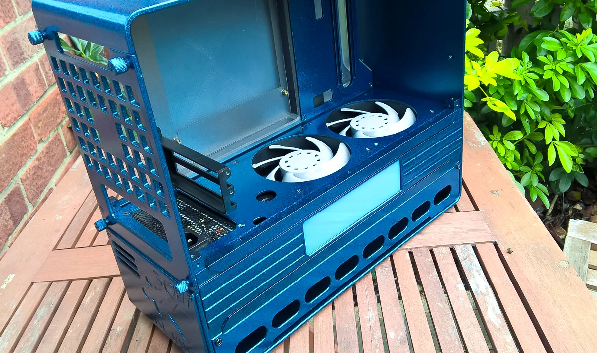

First stage paint on today and I machined the plastic inserts for the side panels!
And its ma burfday intit.!
Nice paintjob! Is that a metallic base coat or have you done something devious like added sand to give it texture and then flatten it out in the gloss coat?
Have a good one and have a beer for me! :D
Brilliant to see you up and running with Celestial again. Really looking forward to seeing how you get on. The paint looks lovely - RR paint store...?
looking good buddy, have a good birthday!
Thanks fella,getting on a bit now tho...scary.
Its a coarse blue flake in a metallic base over black.
Because its a flake,its a rough as a bears arse but you need it to be like that to get the pop.
No,RR have not been very......communicative,so I just mixed what I think is as close as im willing to go,there are purple tones that I didnt put in for example.
External holes filled,now to paint the outer shell and lots of clearcoat!
I love this little In Win 901.
Its been a challenge and there is still hardwork to be done but its starting to look more like it did in my head!
Looking mint. The dual fans remind me of a crazy metallic blue hard drive cooler I had years ago.
I see you stuck with the 8 vents rather than recutting for 6 in the end.
