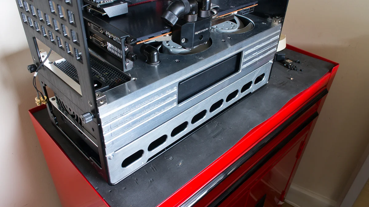

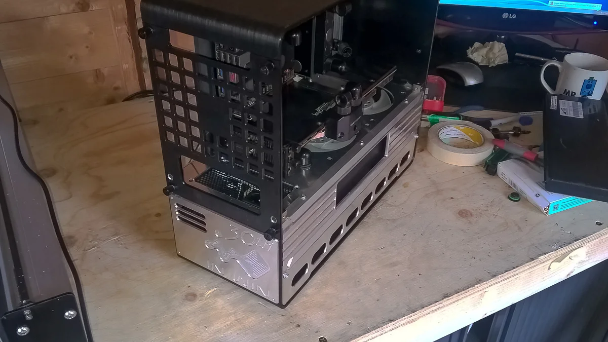

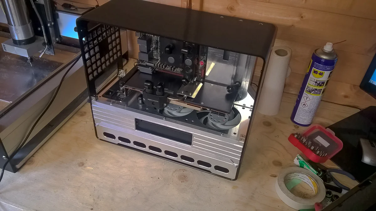

In a small update,both rad box panels are nearly done,along with the exhaust panels!
The rad box has detail work mimicking the rocker covers of that amazing engine. They will have mesh backing I think to finish the look.
Here is a view of that amazing engine,you can see what I have run with,coupling that with the door sills gives me a nice bit of detailing to add substance.
I have made a booboo...I thought the engine was a v16.....and it isnt,its a v12 so the design of 8 ports per side needs to be changed to 6 ports per side... :rolleyes:
So...I have ordered more Alu to recut the lower panels and cut the replacement top door section.
I really should check things more often.....

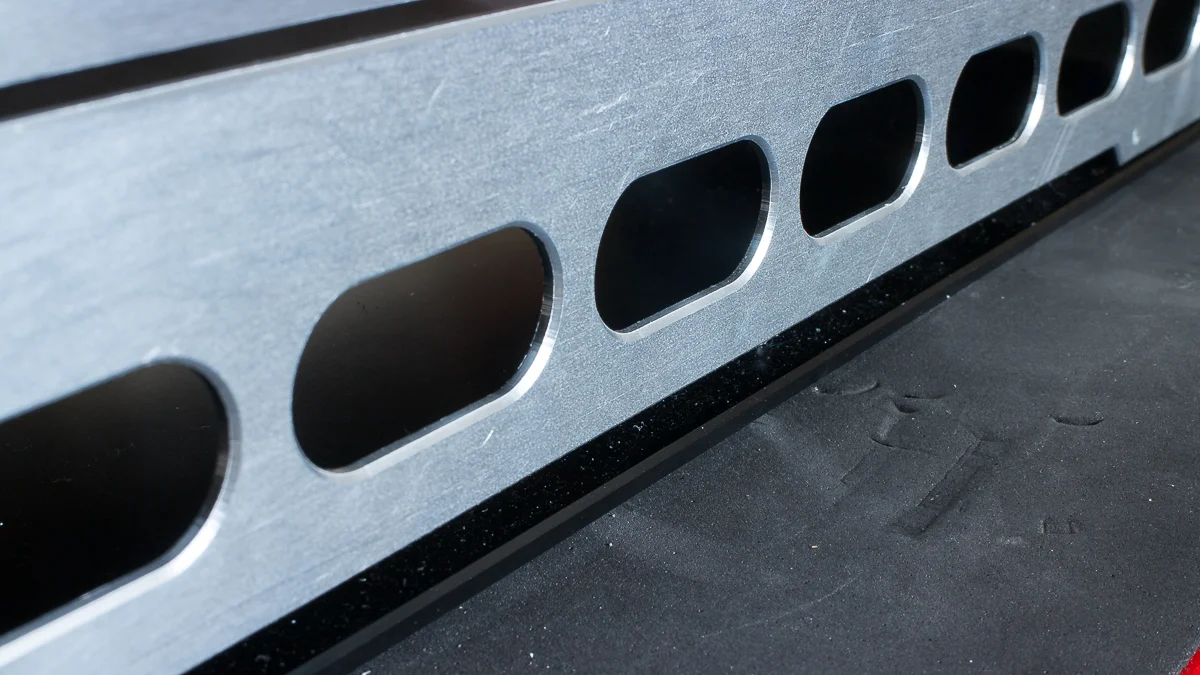

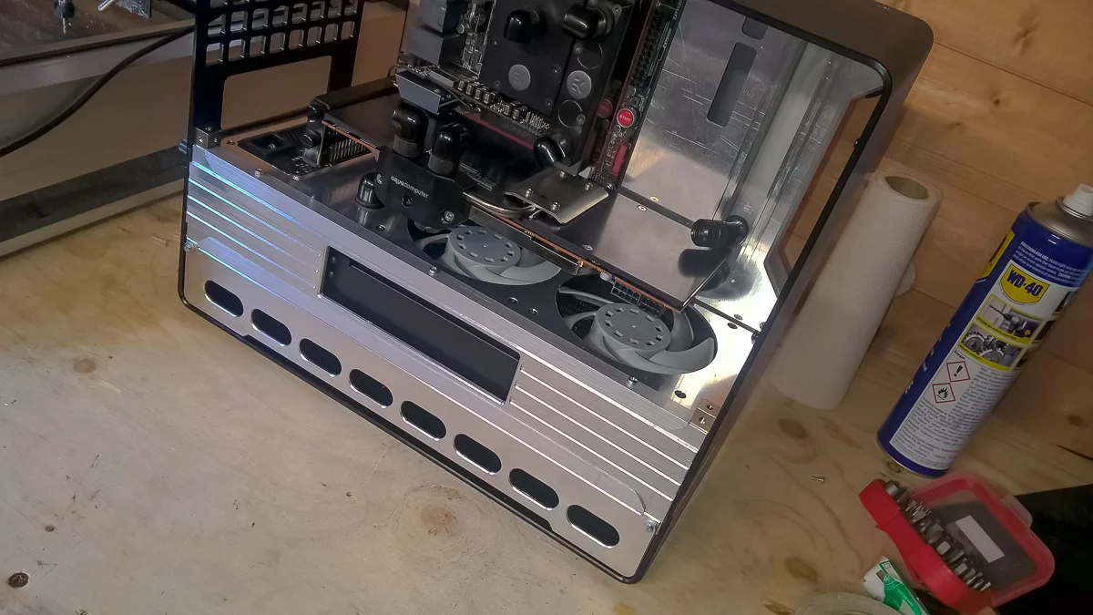

It's the quality of the finish on the bevels of the ports that gets me. What have you got to do that with? ...just so I can look at one lustfully and not be able to afford one :D
CNC mill,this was a 2 stage job with a tool swap. 3mm endmill for the contours and a 6mm chamfer mill for the bevelling.

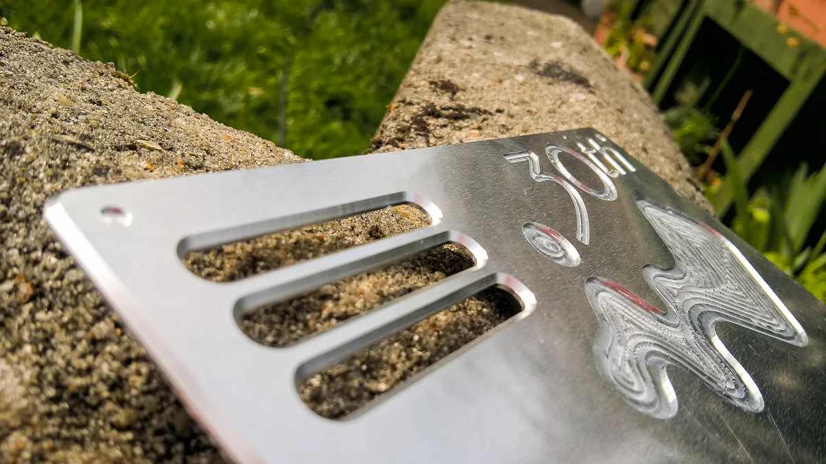

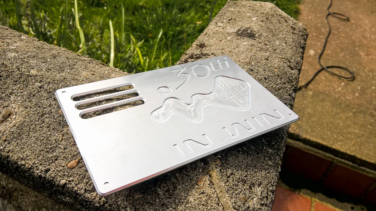

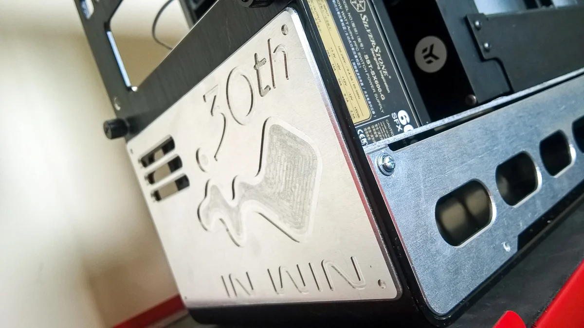

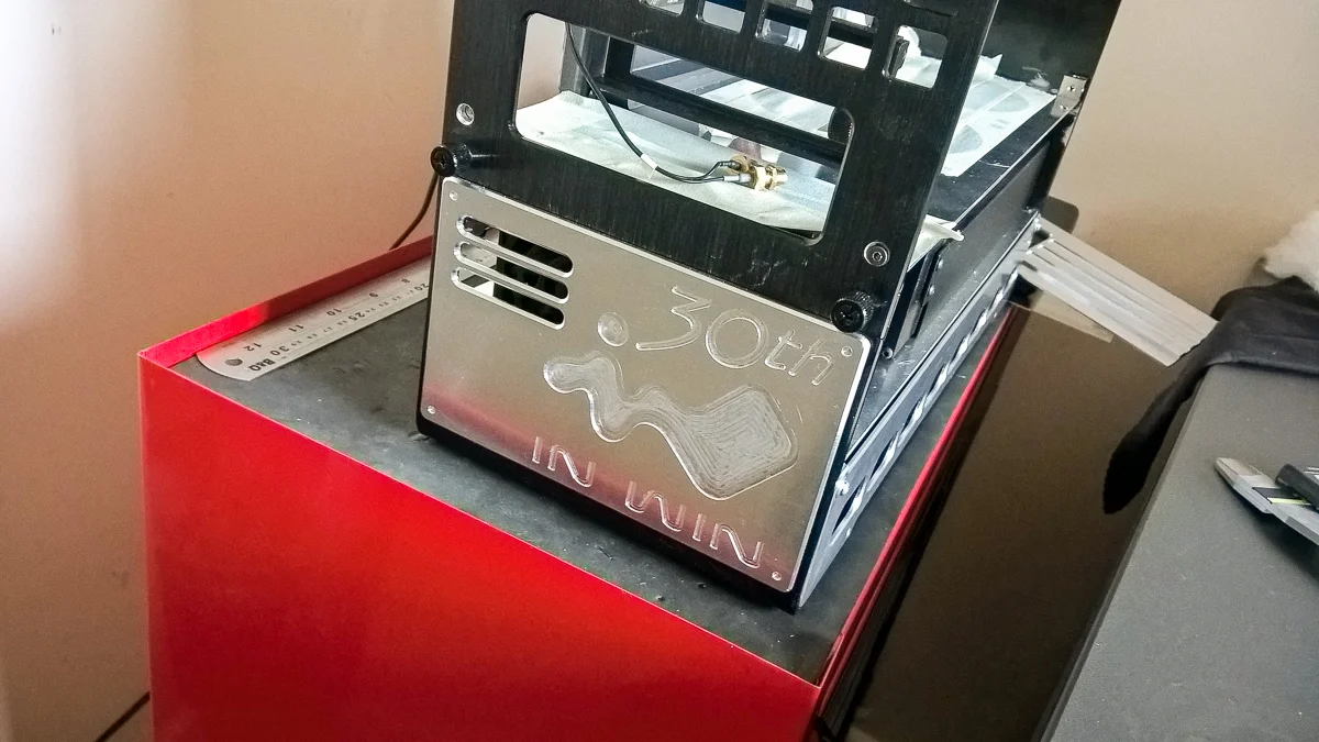

Today was all about the PSU cover now its a defunct mount and seeing as its In Wins 30th Anniversary I thought I would mark the moment....
Some slot work to promote some airflow and a nice machined 30th Anniversary logo!

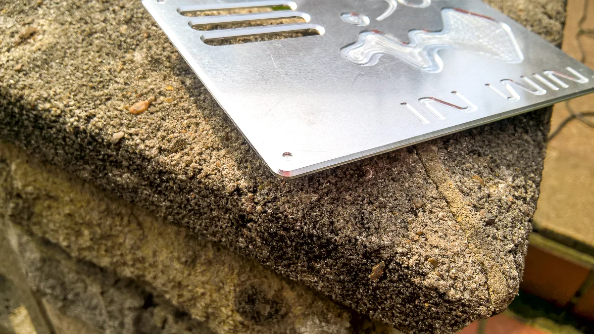

Some lovely chamfers.....everybody loves chamfers right?
And the article in place,I still have to drill out the bolt holes and trim the case near one of the slots tho.
The idea is to paint these then flood fill the recess with clearcoat,when its dry,sand it right back and you are left with the visual cue of depth but it will be flat to the touch.

Outstanding. And yes, lovely chamfers. Certainly look better than my simple de-burring! Like the sound of the paint finish, can't wait to see pics.
Those chamfers look sublime, also the channels for the paint to fill are a great idea as it should give it a unique look. I can't wait to see them painted as I'm interested to see the actual finished effect/depth it will have :)
