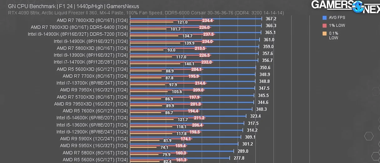

The 7800X3D is considerably overhyped though in my opinion even purely gaming, unless doing e-sports 1080p high refresh stuff, its gains are at resolutions and settings which most people won't be running when paired up with something like a 4080/7900 or 4090, and can't stretch its legs at lower resolutions when paired up with slower GPUs, while it falls well behind when it comes to anything non-gaming.
Here for example is another source showing a typical gaming scenario at 1440P:
If purely gaming, even then its main benefits are at 1080p which outside of e-sports people aren't likely to be running paired with a GPU like the 4090. (There are the odd title where it still is way out ahead at 1440p but then some it doesn't do so well so swings and roundabouts a bit).
For anything else there are better CPUs out there.
Yes for purely gaming it's the best and close to £300 nothing beats it , 1440p it can show , future GPU upgrade it will be in a better place to show it more
I dont think its over hyped its gaming king whilst sipping on power
