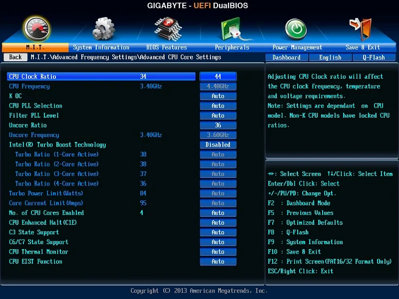

How do you disable the turbo in an ASUS UEFI BIOS, can't seem to see the option. Is it done by default whan you sync all cores?
I'm not sure how it's disabled on ASUS BIOS, here's where it's changed in mine. The screen cap is from my 4670k @ 4.4 but it's the same idea for 4790k.

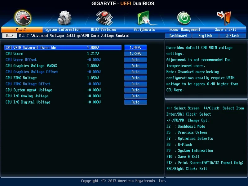

Vcore was 1.22...

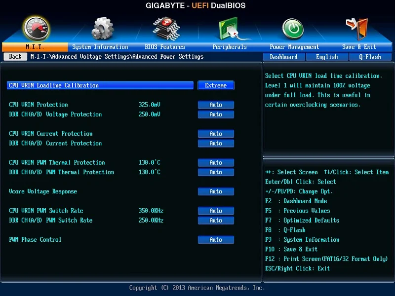

And LLC was set to extreme (note the description on the right hand side, explaining the effect on voltage)...
Can't extreme LLC settings boost vCore above the configured value under load?
No, the opposite is true. If I dial it down a notch, the vcore will fluctuate a little. The lowest setting has it fluctuating all over the place.
When set to extreme, the vcore never changes regardless of core clock.
Experiment a little with yours. Set a mild overclock and see what effect the different LLC settings have when under load. Just be careful, because when I set mine at the opposite end of extreme the vcore can fluctuate a lot.
On the last 2 GA boards i have had LLC made no differance what ever the setting the vcore was rock solid. However on other board yes the vcore can over volt a little.
With my 4670k @ 4.2Ghz with 1.278v under full load tests i got a 0.002 drop when the cores was first loaded up then it was just rock solid at the set vcore with LLC on high.
