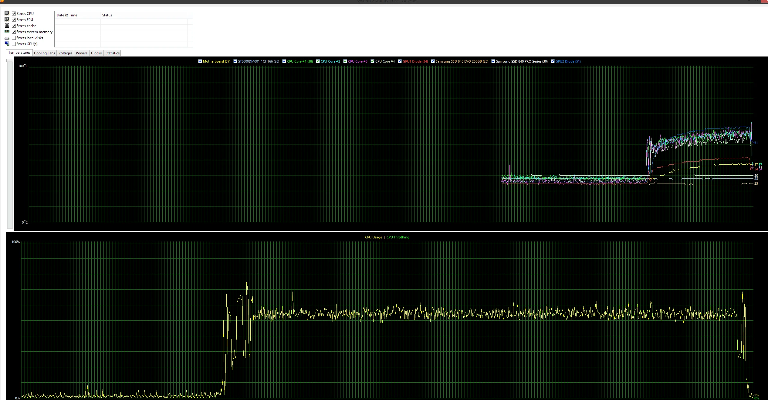

Mine sits mid 60s when gaming. I think my temps are fine as far as maximum goes, but the graph in Aida shows constant peaks and troughs and I can't remember it being like that before. At first I thought it was micro bubbles but the loops been filled for a month now.
Here's a screenshot...
As you can see, temps barely rise above 60C but they aren't very uniform.
It's probably normal, I just haven't paid much attention to it before. :confused:
Here's a full size pic...
P95 ver 28.5 sent temps to mid 90's at stock on both 4790k's I've owned. Games usually anything from 60-75c at 4.7 on 1.300.
