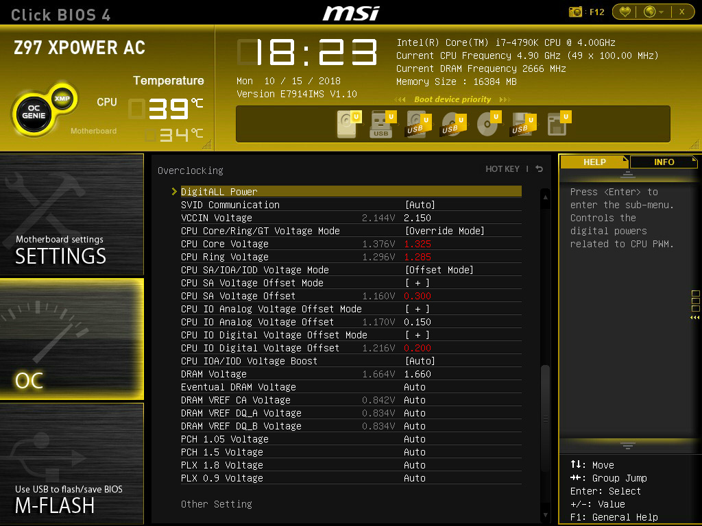

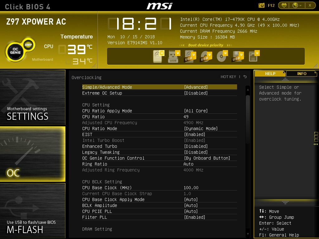

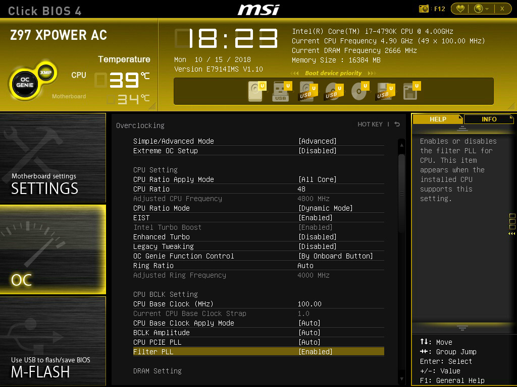

So I recently delidded my CPU and have it running on a 150i. (Why did I wait so long) I've been able to get past my previous thermal barrier at 4.4Ghz and find myself in 4.8Ghz land. I've been trying to get 4.9Ghz but am struggling. Cooling isnt an issue right now as happily sits around 67-68c. Been about 3 years since I touched all this so memory is a bit rusty.
I have a couple of goals.
  • Get 4.8Ghz running with the minum amount of volts for 24/7 using ie gaming and light office work. I'm not crunching videos.
  • Get 4.9Ghz/5.0Ghz Fun fun or maybe 24/7 if I get lucky.
Here are the settings I am using with my MSI Z97 XPower AC using v1.10 BIOS which is the latest along with microcode 24.
Can anyone offer advice/comment on how to improve and acheive this?
Thanks
4.8
http://www.kosch.co.uk/images/ocuk/48-page1.jpg
http://www.kosch.co.uk/images/ocuk/48-page2.jpg
4.9
http://www.kosch.co.uk/images/ocuk/49-page1.jpg
