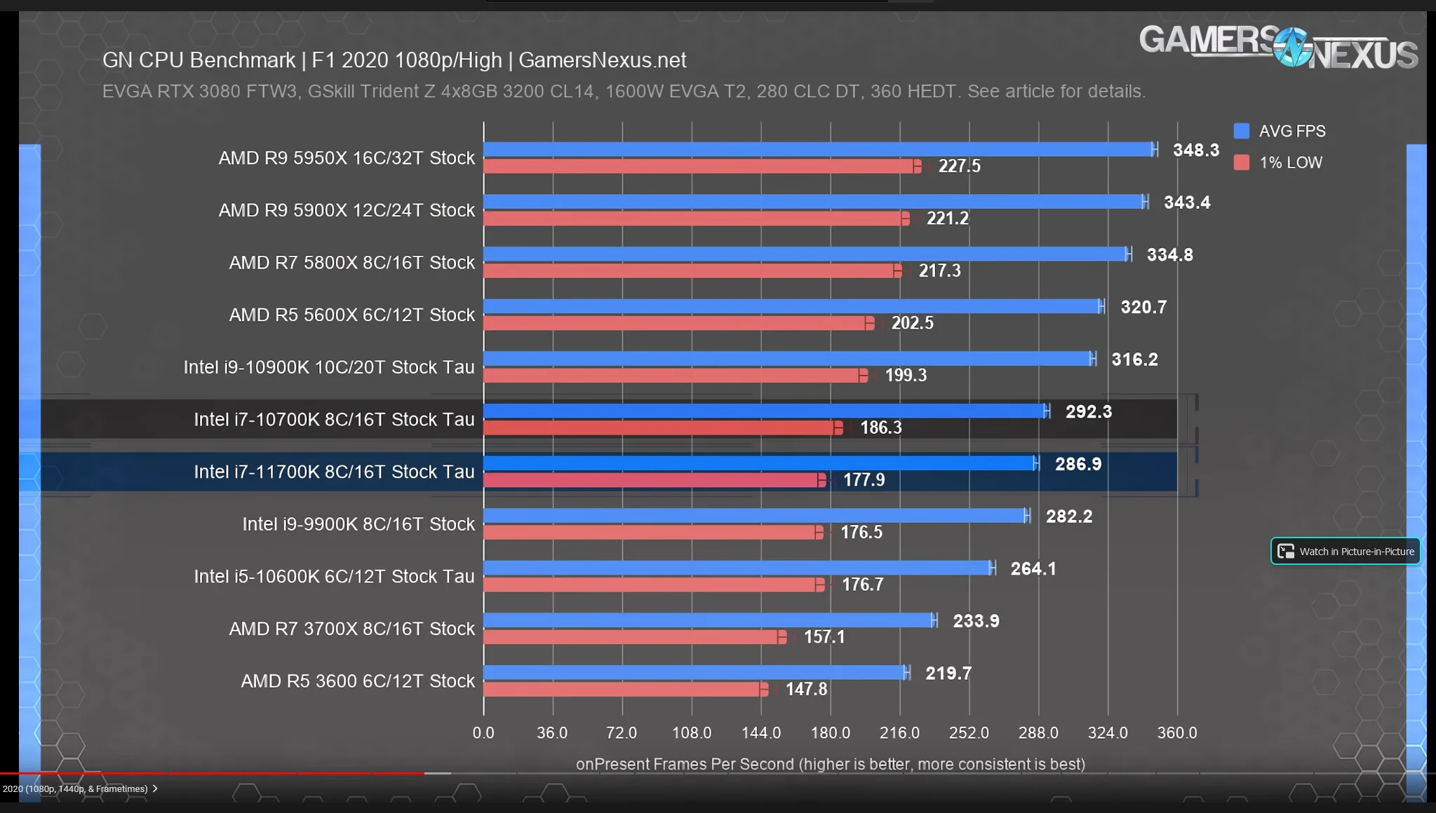

It's on par with a 5600X at 1440P + even with an RTX 3090.
When i can finally get my hands on one I would probably be running a 3070 or 3080 (if it's at a decent price) and hopefully a 5800x. What AIO/fan cooler would you recommend using for it?
A large high end tower cooler is probably best for it, if you want an AIO an Arctic Liquid Freezer II 280 or 240.
In every game?
