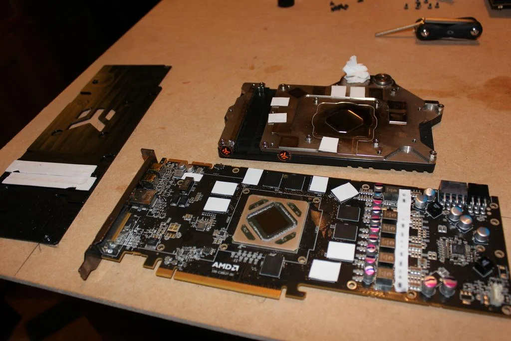

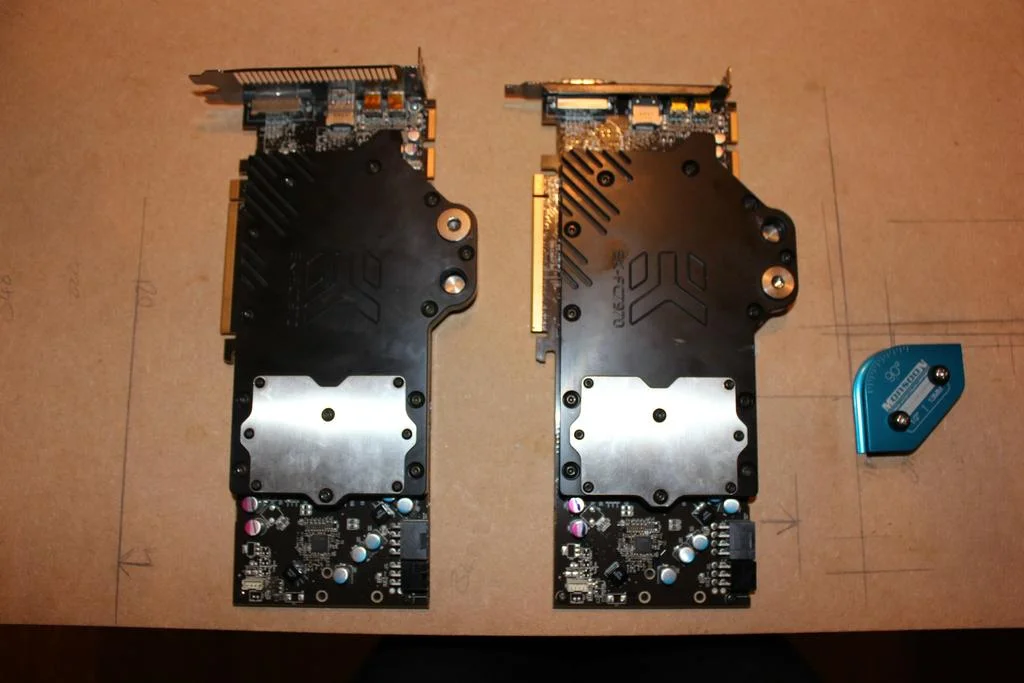

The first thing I done was strip and re-paste the blocks. I noticed card two (Which is now card one) when I took the block off there wasn't a great deal of paste on either two of the sides of the chip, which explains why that card was quite a bit hotter than card 1, which was odd as that was getting the fresh supply of cooler, coolant.
Anyway, both apart and back together with no problems at all.
Card all stripped and cleaned. I done one at a time incase something went wrong then I still had one working. I also managed to spill some coolant onto card 1 which he didn't like too much.
The paste is awesome, it comes with an epic little spreader thing which is well handy! Was having too much fun with it to get any pictures sadly.
All back together and clean too.

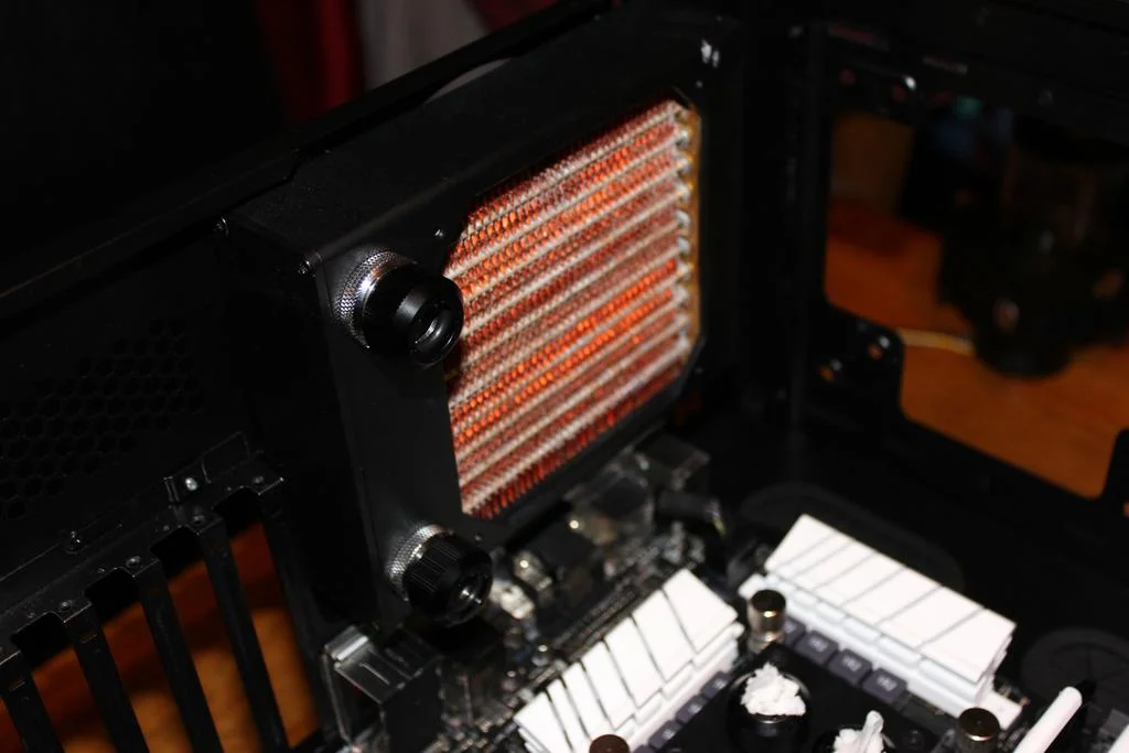

One 120mm radiator fixed into place after being flushed with some DI water.

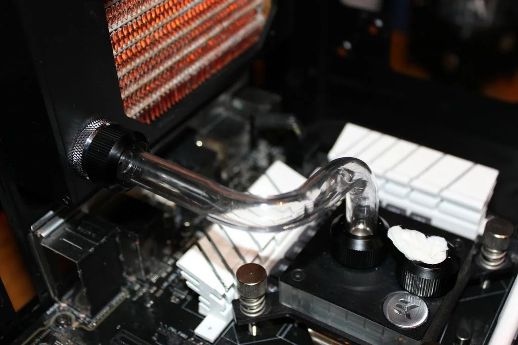

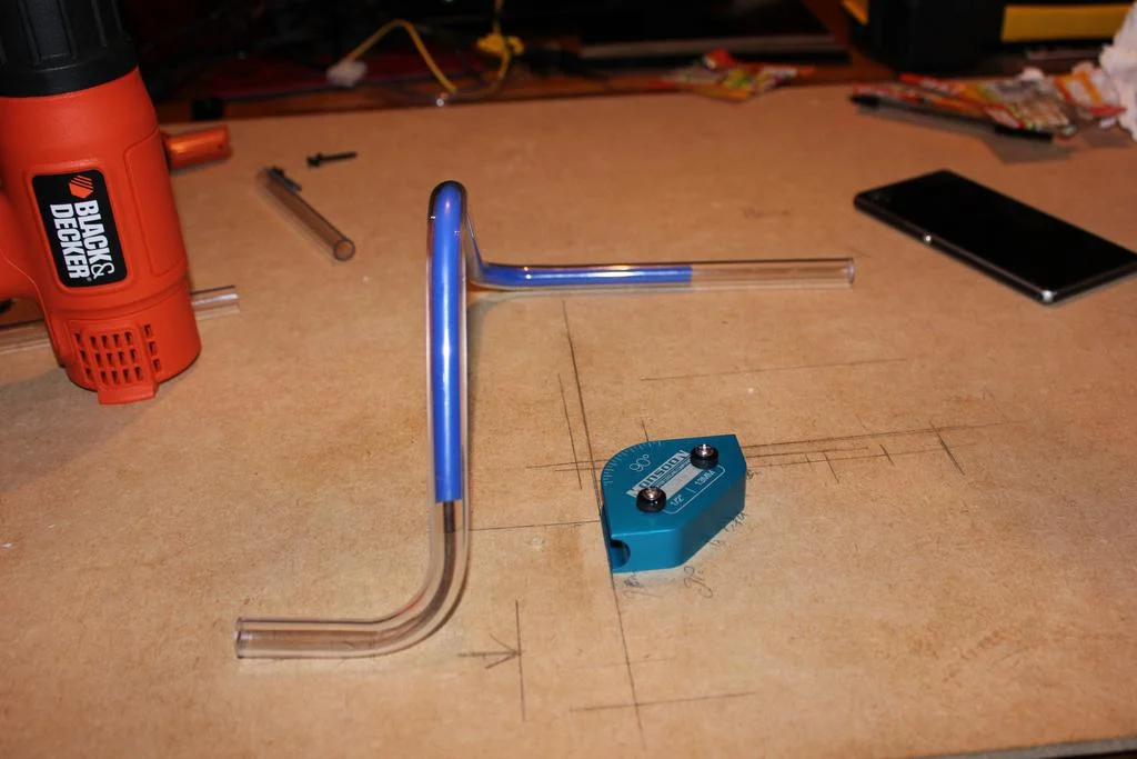

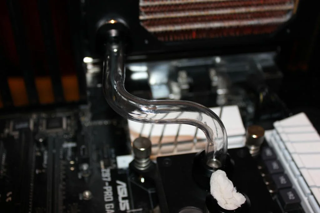

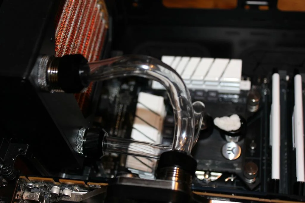

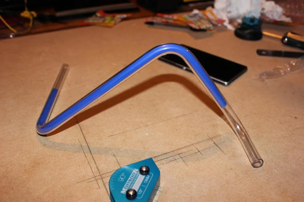

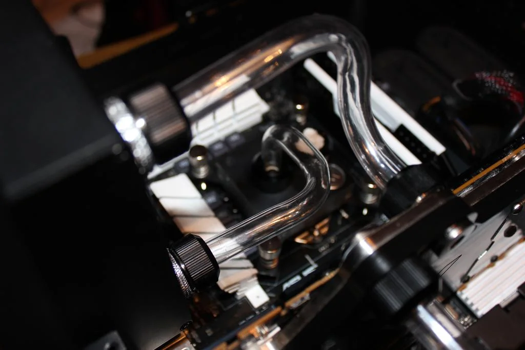

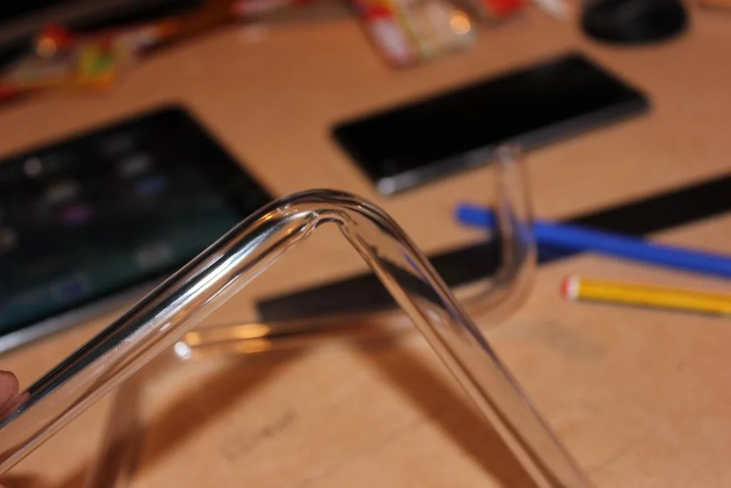

I thought this bend would be close enough between the radiator and the CPU. I couldn't have been more wrong.
I got a bit carried away with bending and didn't take pictures but after much measuring, heating, tweaking, trimming we got there!
Not one of my prettiest and the pictures looks like there's loads of marks when there isn't, it looks quite neat in person. It also looks pretty drunk in the second picture. It's actually straight. I made sure of it!

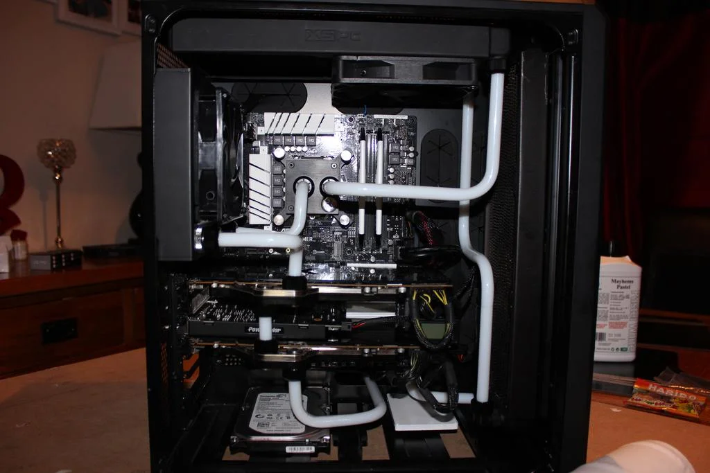

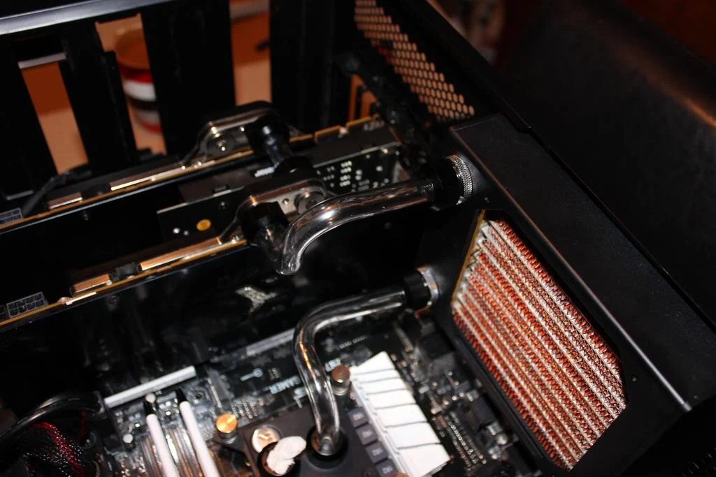

Then it was time to go from GPU 1 to the newly found radiator..
This was first attempt with no measuring to make sure it was possible.
Hmm...
Something is not quite right here but i'm not sure what it is yet! :D
Hmm...

Looking good, but think the admins will have something to say about those naked pictures hehe, geekbanter :p
What fans are you getting?? Need some for my new rig, and for my H100.
As always looking good, those blocks look very nice fitted on the cards (They give it a beefy look) and don't worry about the tubing runs as when I did my build there were appeard to be marks on the tubing but as soon as the coolant ran through it they vanished. :)
I'm not quite sure about the last run though :D
Yeah the last run got redone and turned out pretty well. That first one was awful!

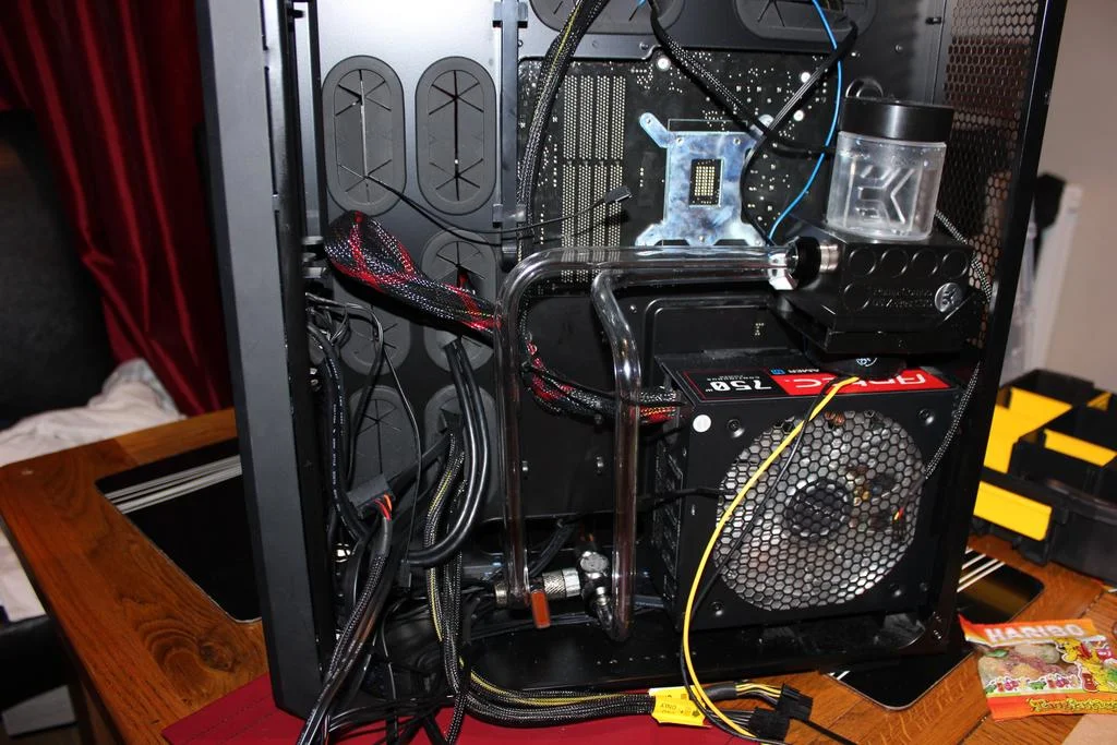

Should be finished tonight. Just got to get the tubing behind the case done including the drain port.. Going to be fun!

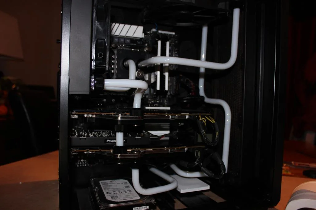

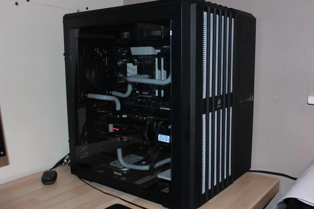

It's complete!!! And am I proud :D

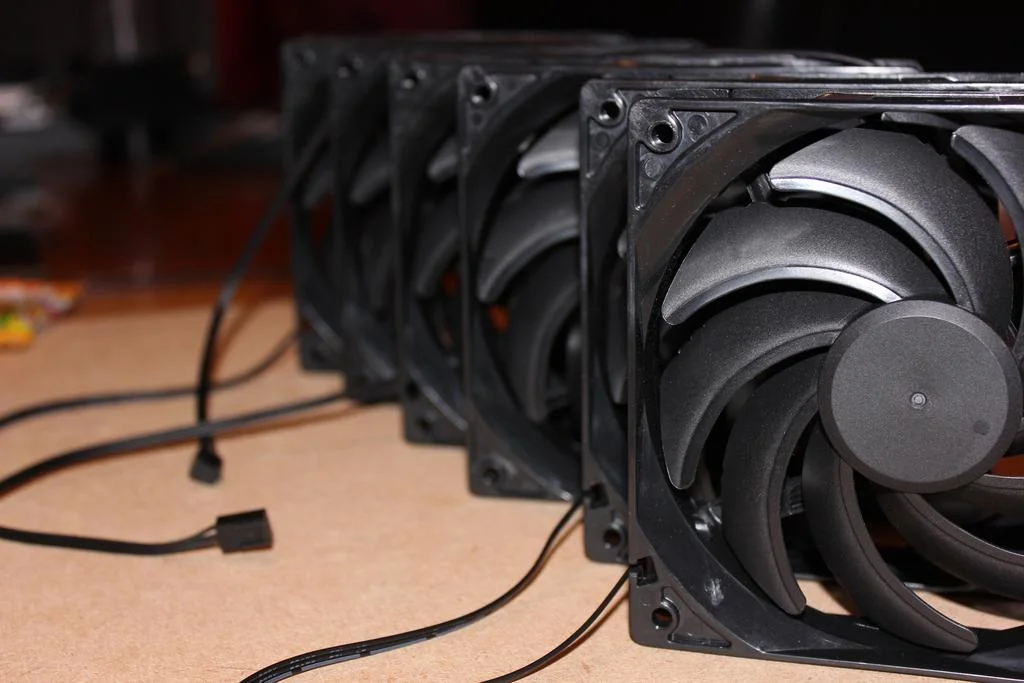

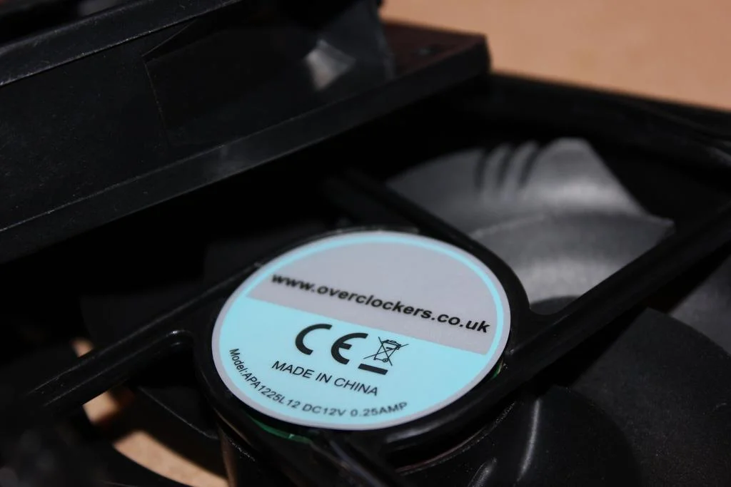

The OcUK fans turned up today, they are so good!! Silent and work so well.

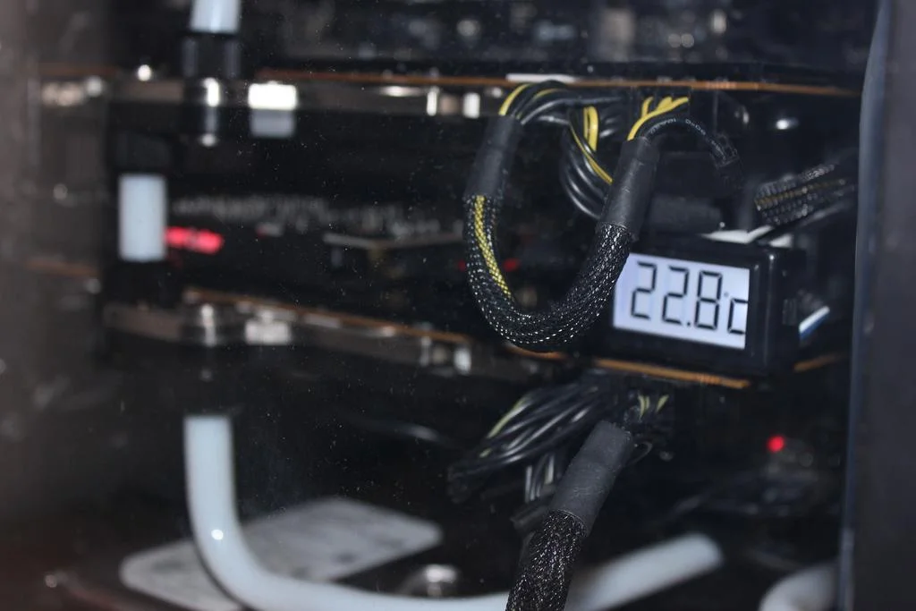

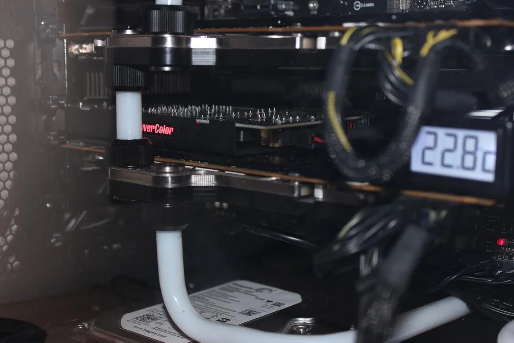

With the blocks repasted, I forgot the cpu but hey ho.. sitting happily at a idle temp of 25c.
Was hoping for a slightly better sticker, maybe with the OcUK logo on it.
So I left last night with no tubing from the gpu and rad to the pump. So today I had to make them up, also redo my GPU to 120mm Rad tube as the last was awful! :D
I was getting carried away and pictures got forgotten sadly. I am getting much better at this bending business!

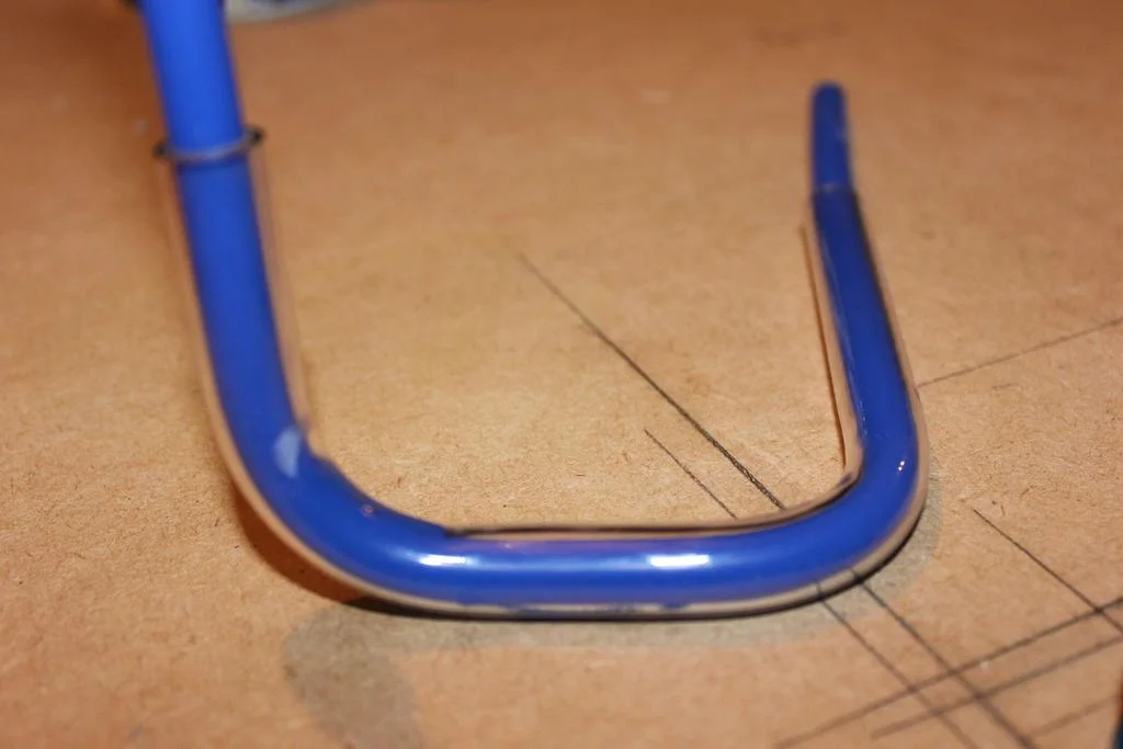

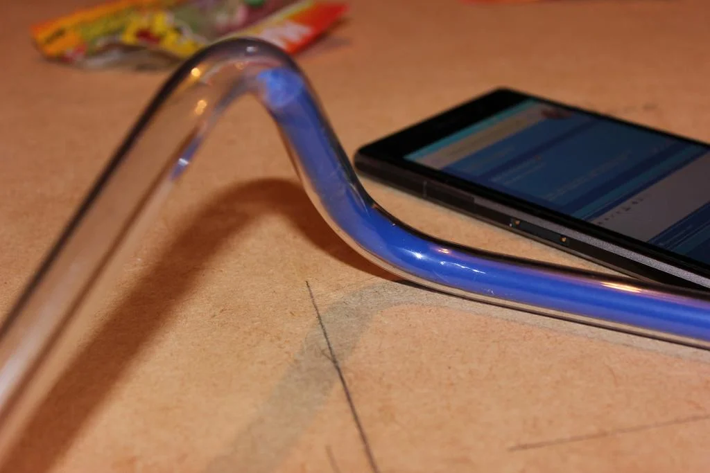

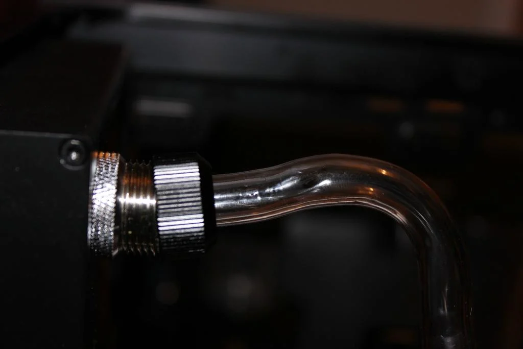

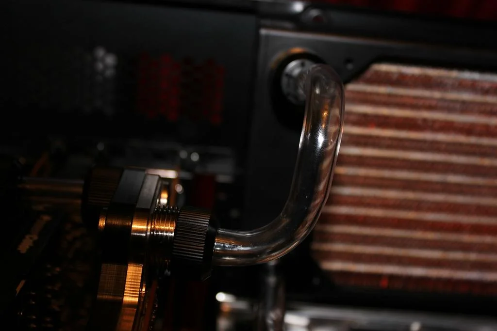

Had to bend this slightly inwards so that I made good contact with the fitting.

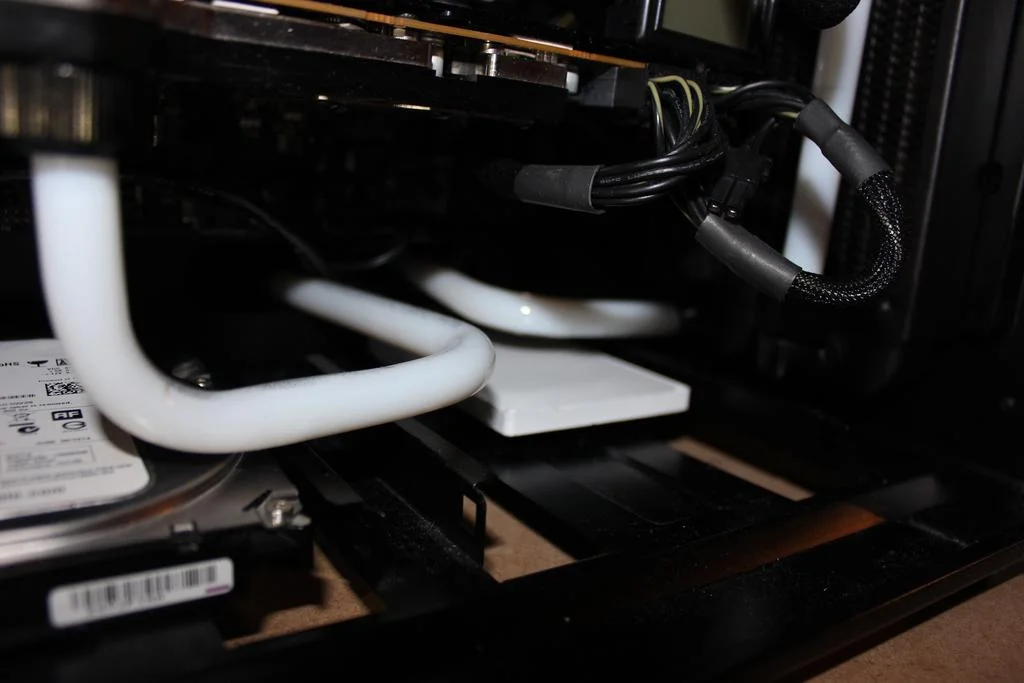

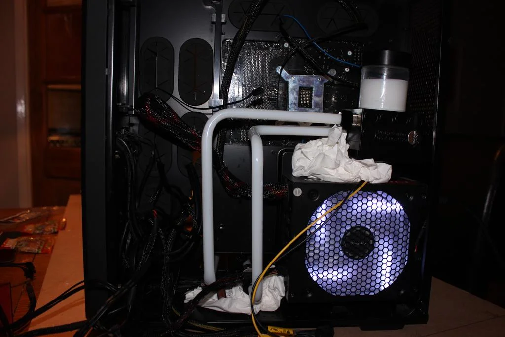

This was my tube running from the rad to the inlet port on the pump, I made a bit of a boo boo which I was really annoyed about as the bends on this were perfect, the size everything on this was amazing! But can you guess what's wrong?
This was the bend from the rad into the drain port.
By this point my fingers were so used to the heat it didn't really matter where I held it!

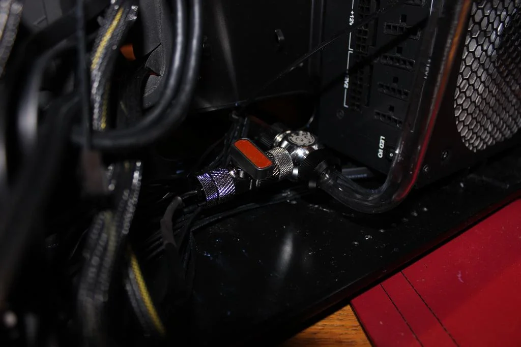

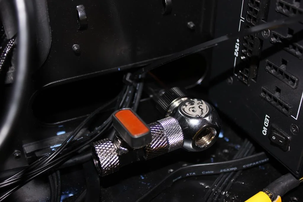

I then added In my drain port.. Again, something else I didn't think about, wrong tube, this is the outlet, so it doesn't really drain at all.. I only realised this when I had to try and drain the loop as I had one leak where I forgot to tighten a fitting. I also added my water temp sensor onto the end with the valve open so it will read the temp.
Now to get this bend without getting the blue thing stuck I had to do it without which went.. Badly.. So here we are, I purposely kinked it as there was no way it was holding it's own without being really flat, I'm still getting a good flow rate and it's not causing me any issues. But i'm not happy with it by any means.
And BAM! They were done!

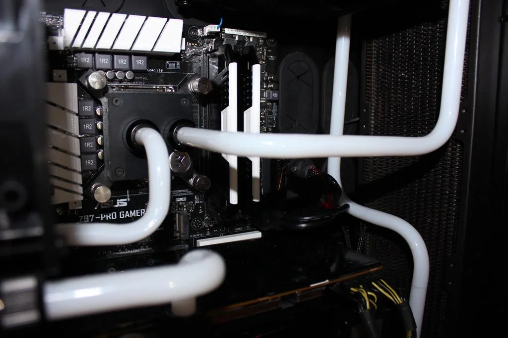

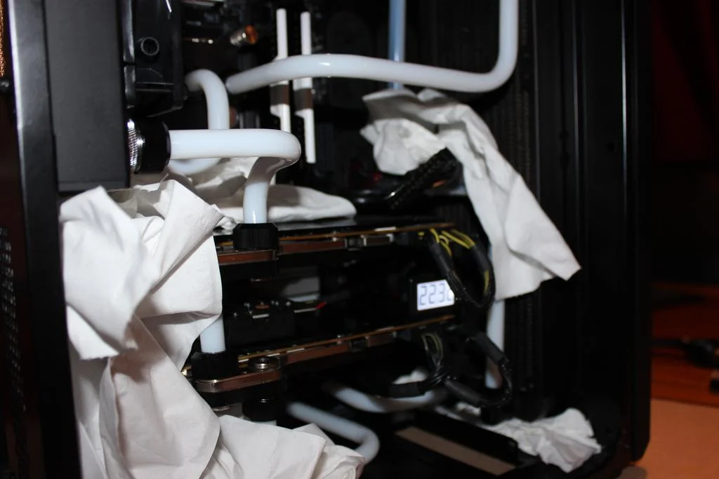

And then time to bleed and fill the loop. I had to ramp up the pump from 2 up to 4 as it wasn't getting enough flow to complete the loop but everything is fine now.

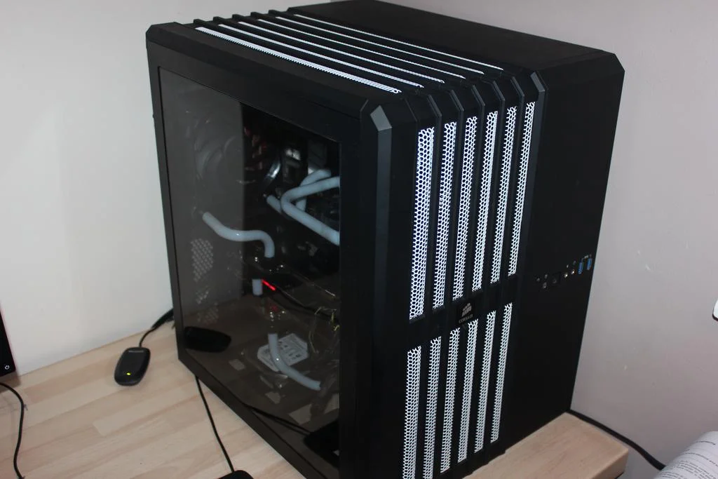

And now the pictures can talk..
Here are some in my room powered up.
My lighting hasn't turned up yet but that's an easy install once here and Pexon hasn't got back to me yet, he did say he was pretty busy so i'll let him off ;)
But other than them two little things, it's finished infact i'm typing this from it now!
Temps are much better now and I'm really, really, really happy with how it's gone.
