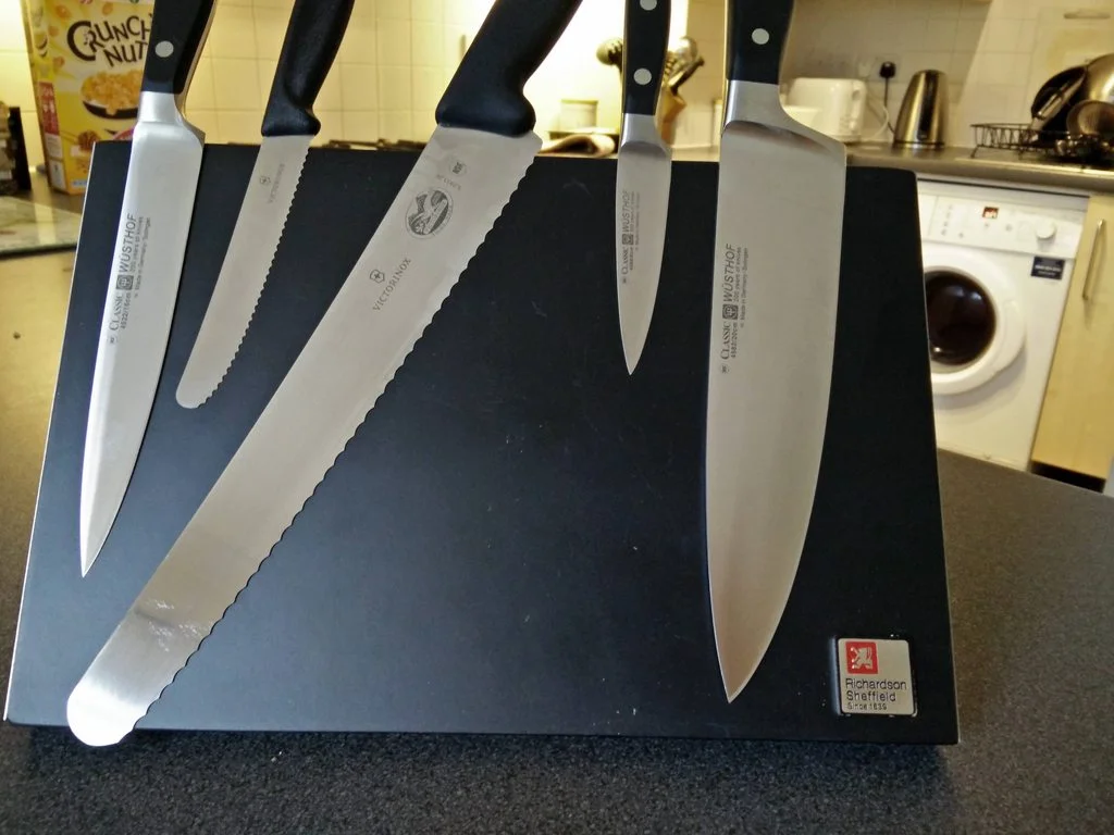

Recently started my collection too, currently rocking this:
The utility knife on the left came in a set with the 20cm chefs and 9cm paring knives, and was actually cheaper than buying those 2 separately.
