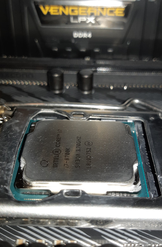

Hello guys. I have been using pastes for many years and never had an issue. Bought Kryonaut from a reliable big computer store who always make sure their stuff is tip top and i put it on my i7-8700K with an after market CPU cooler. 24 hours later after normal use (wanted to test a few pastes to find the best for normal use) i took it off and my IHS is scratched plus my CPU cooler looks even worse. Almost like i had taken a screwdriver and jammed it into the metal causing metal spikes coming out of it.
What is going on with this paste?! Even the shop barely believed me until i sent photos and also told them im educated on PC hardware and have done this for decades building PC's. They told me to come in with the CPU, paste and cooler so they can take a closer look. I have warranty on everything and i have proof that my previous CPU i used the same cooler for has not a single scratch on it. I bought that CPU from them as well plus the cooler so they can see a timeline of my hardware i bought.

Bought NH-D15 cooler now and will go with NT-H1 for the time being. I will upload images when i get the chance (few days) so you can see how it looks. I tested Arctic Silver 5, all good, tested NT-H1, all good, MX-4, all good, Kryonaut, tons of scratches and all messed up. I use isopropanol to clean and always make sure its real clean. I didnt OC. Didnt push heat stress testing my CPU. Just normal use.
Its obvious some people have a good experience with Kryonaut and thats great, but my advice to someone who never used it before - use the very batch you buy on some older cooler/CPU you dont mind scratching just to be sure the batch you got is OK. Do not just put it on if you bought/saved up money for a brand new expensive CPU/cooler in case this happens to you too.

This is what it looks like after kryonaut on my IHS:
strange you decided to pull your cooler after seeing this thread ..and only having 2 posts here .. oh well there does not seem to be much wrong in that picture ?
I Googled problems with kryonnaut after my problem happened. Found this thread and wrote what happened to me. How that is "wrong" baffles me? All i saw previously to buying the paste was how good it was. Thougt i was the only one hit with this issue and found out i wasnt in this thread.
Bad attitude.
Bad attitude.
i'll say it again .. not much wrong in that picture no scratches dints or marks I can see ...?
