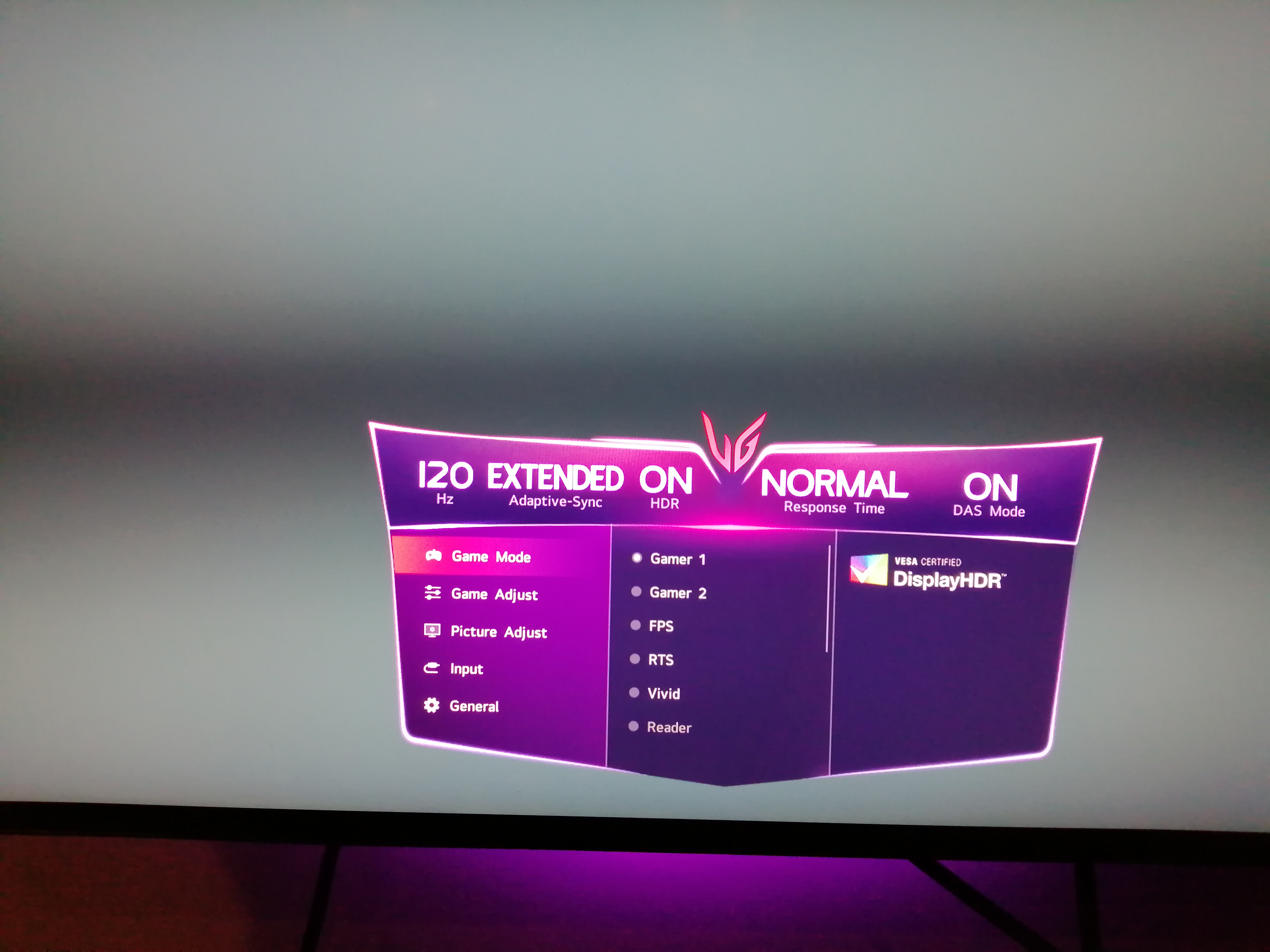

I updated to 4.07_DV51_NV6.07 and for some strange reason DP 1.4 (DSC) and DP 1.4 don't work anymore and I'm having the same issue with HDMI 2.1 where I can't select anything over 60Hz... all I get is either a black screen or a screen of a solid colour (blue, grey or blue).
Running an Nvidia 4080 with 31.0.15.3667 12/07/2023.
Plugging in a PS5 appears to work fine at frequencies above 60Hz.
Anyone got any thoughts?
That's the thing... everything was working ok with an older Nvidia driver until a few months back I updated the driver and 144Hz stopped working after a reboot (black screen).Sorry for the late reply. I didn't get an email notification.
