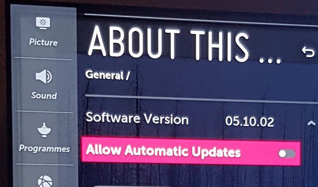

How do you do that ?
Several ways to get into the service screen but I did it with a Harmony remote.
press the 'in-start' button with password 0413
'system 2' menu and change NSU from user to engineer
restart then do an OTA check for update.
Not committed to doing it myself yet but went through all the steps except the change and reboot as will see if others experience any downsides.
A few people have done it on the comments section of
I think I will wait for an official update seems safer.... lol
Sod it ;) don't fancy waiting nearly two months for LG.
Enabled GSync, ran 'pendulum demo' and not a black screen to be seen :D
I'm mad as a box of frogs so don't try this at home kids.
I only have my laptop with G-Sync with a 2070. It seemed to work ok when I tried it briefly...
The issue was related to 4k @ 120hz with G-Sync. So basically only something the new Ampere GPUs will do with HDMI 2.1. Your laptop would not see the issue. With this fix you can get everything running full glory with a 3xxx card: 4k, 120Hz, 4:4:4 Chroma, HDR, and G-Sync etc
