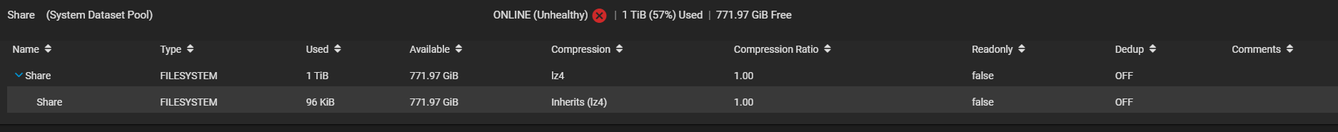

I took the server apart, and the 3 40mm fans in the hot swap planes had basically spewed their oil everywhere. I then found that there are 22 screws in each bay just to get the old fans out :( And then 12 x 4 to fit the drives. Needless to say I spent the entire day with a screwdriver in hand.
Now you may be wondering where the fans went. Well, two of the 3 Arctic slims had decided to just up and die. As such one of my mech drives was hanging on for dear life in there.
I only lost about 8 FLAC files so it wasn't terrible. I have now set up the 12 in ZFS 2, which gives me 10tb unformatted and two for spares in case any die. So I can lose two before that happens. However, I have a pair of old hardly used 1tb surveillance drives I bought from OCUK years ago. So those will go in to replace the dead drive and the 3tb sitting next to it, and also be used in case of a failure.
