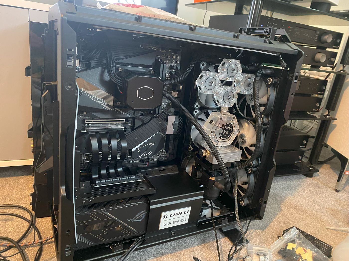

After spending an hour yesterday packing everything I got it home earlier. I was dying to do this.
It worked !
OK. So what didn't work. Well, firstly the pump top I have is so big it could not be screwed into the mount I bought. I realised I had to flip it upside down. Which at first I was very annoyed about. However, I soon realised that the TEC pump mount had two smaller holes in it. And, well, you couldn't make it up.......
So with that success being enough for one day I then mounted it solid (the pump and res and cascade) and put the shroud on for a nosey.

It wasn't in my server after all ffs. It was in a decommissioned rig at mum's waiting to be emptied out and chucked away.
Also. This has been one of the best things I ever bought tbh. A small rig I can take anywhere, but more importantly acts as a stand in when I have mine in bits.
One last (he said, hopefully) order from OCUK. This will be my floor fan now. Not only does it have the screen on, but it is reverse flow. So you get the pretty side. Was B grade, 25 quid.
I also need a straight rotary for the res to the cascade. It's currently loose on set fittings.
Sadly all the Barrow ones were sold out :(
OK so I made room.
Before that though I tested the fans and RGB. I also finally managed to get the neons straight, among tons of other small jobs.
Like I said, I then made room for the T ball thing. Ignore it for now, you won't see it next time I am back at the CNC. I also realised that due to the end port rad I could hide nearly all of the hose. One will route through the PSU shroud, and go in behind the GPU. All you will see at normal level is the return hose where it comes out of the end of the GPU and goes into the pump.
Both of the two hoses you see there will go into the back of the GPU block.
Also as you can see I will not be fitting RGB to the cascade or res. There is just no point.
Oh and thanks to the hoses on the TEC I could not fit the memory cooler. However, it went right into the back of the PC where you can't normally fit fans there. So it is ideal for getting heat out, and looks awesome :)
