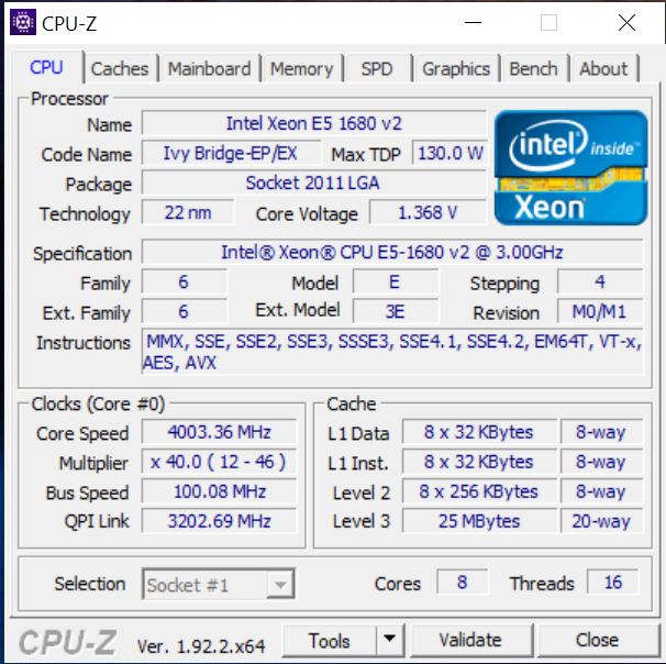

Hi Guys,
EDITED: I originally asked for 4.6ghz and multi cores, however, that makes no sense, but that would mean a lot of people won't be able to post so,
I've amended this to 4.0Ghz
which allows the Ryzen crew in as well, so can any posts now be for 4.0Ghz CPU's please. Thanks guys, would really be good to see a mhz per mhz comparison on all the different chips variations... IT DOESN'T MATTER HOW MANY CORES NOW, SIMPLY AS WE NEED TO CONCENTRATE ON THE SINGLE CORE SCORE ANYWAY!
Using CPU-Z just as a benchmark... This is everyone who's contributed as of yet:
CPUZ SCORES @4Ghz (give or take error on bus)
E5 Xeon 1860 V2: Single Core = 411.8 (Pugheaven)
Ryzen7 3700X: Single Core = 481.7 (EdButler)
Ryzen5 2400G: Single Core = 455.8 (sandys)
Ryzen Threadripper 2970x: Single Core = 464.7 (sandys)
Ryzen5 3600: Single Core = 476.6 (Humbug)
The reason I'm interested in this now is the below video I watched which to me was a really interesting article, so rather than play games, would prefer to look at raw power and the easiest way I suppose is a quick benchmark that takes single and multi into consideration and everyone usually has the app... just be interesting to see if we've come anywhere in the last 7-8 years... I believe AMD have but I'm not convinced with Intel...

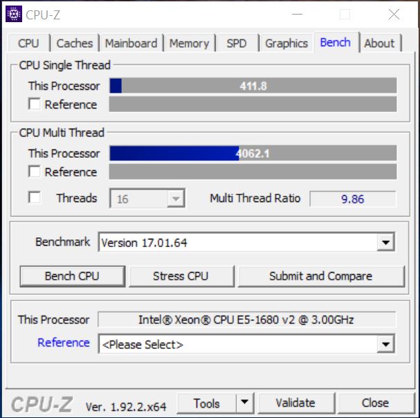

Thats' as near as damn it though mate, so that's a good one to compare to so,if we just took that figure for now is looking like the AMD over an old Xeon is around 17% faster give or take clock for clock for 1 CPU... just based on CPUZ which obviously isn't the be all and end all, but at least it's consistant in it's findings... I wonder if you could do one at as close to 4Ghz as possible mate just for me, as I've amended this thread to a 4Ghz to get more different CPU's in here to just get a ROH.
CPUZ SCORES @4Ghz
E5 Xeon 1860V2: Single Core = 411.8, Multi Thread = 4062.1

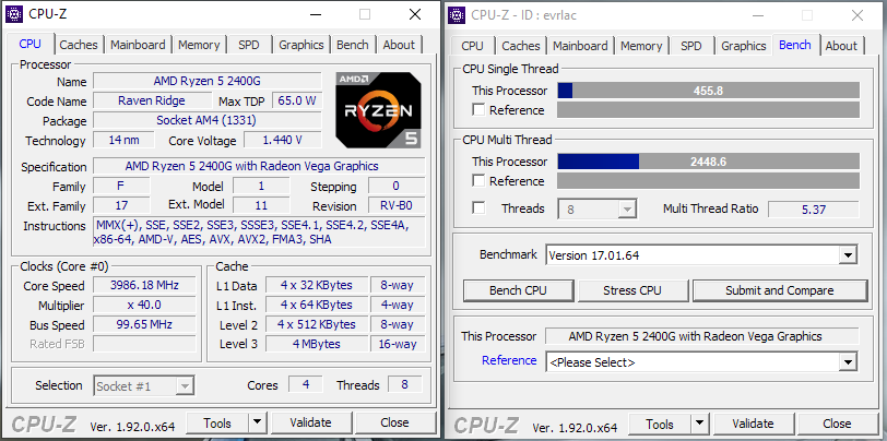

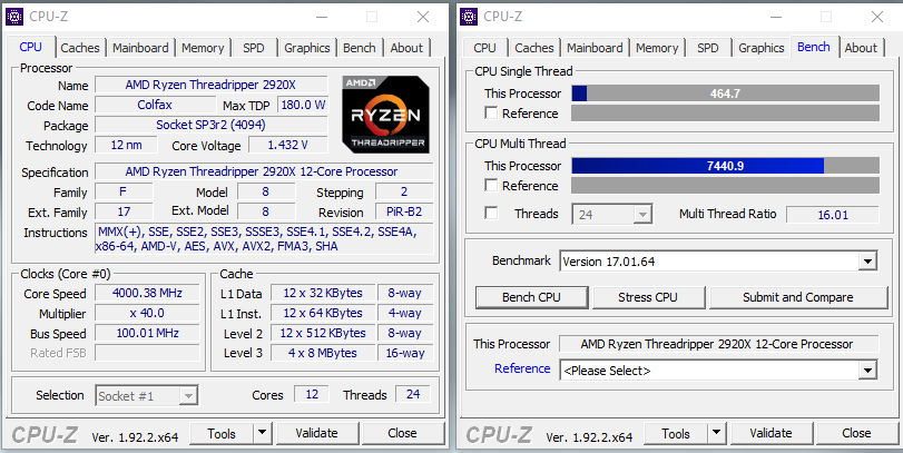

OK my Ryzens at 4ghz both with similar memory timings though one a Ryzen (zen) and the other a TR (zen+) hard to directly compare as one is a pared down cache wise Zen and the other not, but looks very unimpressive for the refresh TR vs OG Ryzen (despite 2xxx code 2400G uses 14nm Zen)
EDIT - Ah just noted that you wanted 8c/16t, I don't have one of those, so will hide images in spoiler tags in case some one is interested anyway
Zen
Zen Plus
