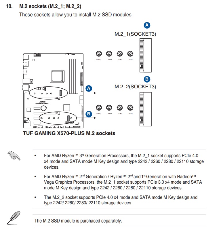

I have asked about this elsewhere but I will ask here too. OK, so this is what my manual says.

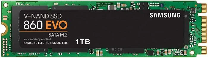

So would this work in there? it's an M key SATA. I don't want to lose lanes, and I really don't want to be running SATA cables either. I'd rather keep it as clean as I can.
Yep that’ll work.
It ought to work as it meets the spec. I think the important question to ALXAndy is whether it'll use zero PCI-E lanes if it's a SATA mode model rather than an NVME model. For the record, I don't know. For what little it's worth I have a pair of NVME M.2's in RAID 0 and they don't show up in HWInfo on a PCI-E lane but under the Intel RST - as SATA if I remember correctly.
Yeah, both confirmed. It will work, it won't use lanes*
And then I read about X570, and how the PCH adds 16 lanes. So *that's* why it has two M.2 slots, a X16 slot and a X4 slot lol. It doesn't matter as it's only for games and was significantly cheaper than a top spec NVME which would cost double.

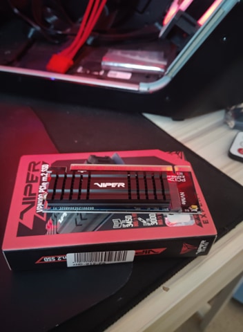

The good news is I can now get something like this.
And also use the 256gb Viper that is still sat in the box lol.

Oh also. M.2 SATA may eat a couple SATA ports, but I don't care about that. Not using them any way.
OK sound card and riser fitted (and installed and working). SSD worked too, so thanks for the advice there guys.

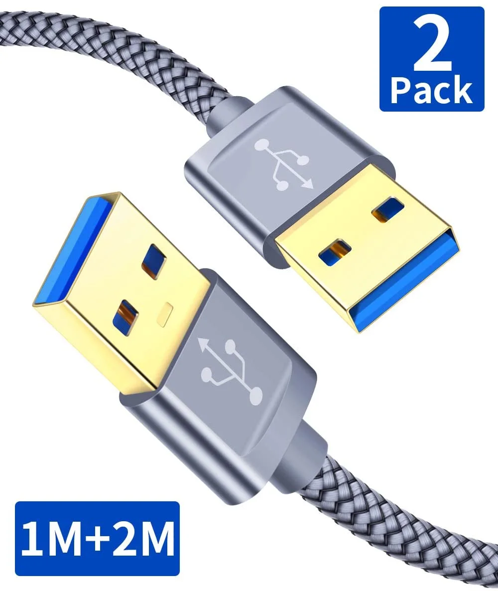

The blue USB cable looks a bit crap, but I've ordered the above. If they are too long I can just get a black 60cm for about £3.

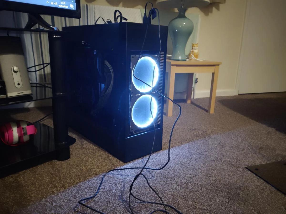

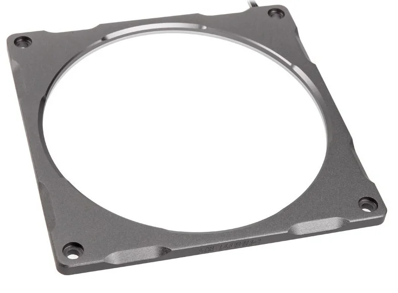

There is one thing I don't like, mind. The front rad mount thing has 140mm holes and 120mm holes. I am using a double 120, so it looks a bit "gappy". Even though the filter.
So I got these in gunmetal. They are 140, so will cover the gap. I won't be hooking up the RGB but they weren't too cheap given they are alu.
Still, £36 in the grand scheme of things didn't seem too bad.

OK, those USB cables don't work. So it's plan B.
I've ordered it in two sizes (10mm and 15mm) and will see how I get on. I also got this
So I am sure that I can come up with something more suitable.

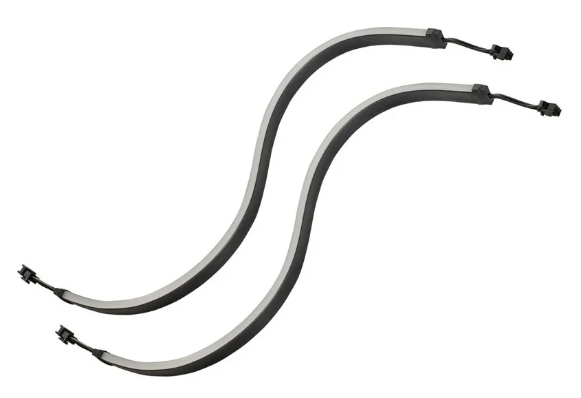

Ugh. Decided to hook up the frames. I had to get this to do so.
I wouldn't have, but HWC did a video on the neons today that I was looking at and I cracked.
I suppose it will be nice to actually see the hardware in there.
No, no. You need to solder resistors onto all the legs of the RGB LEDs individually, by hand. Anything less doesn't show the necessary commitment! ;):p
Dude tbh I don't even want to get my soldering iron out. Sadly I may have to, as the frames are 12v LED and not DRGB. I'm pretty sure the board does both, but yeah no doubt I will have to make some sort of adapter.

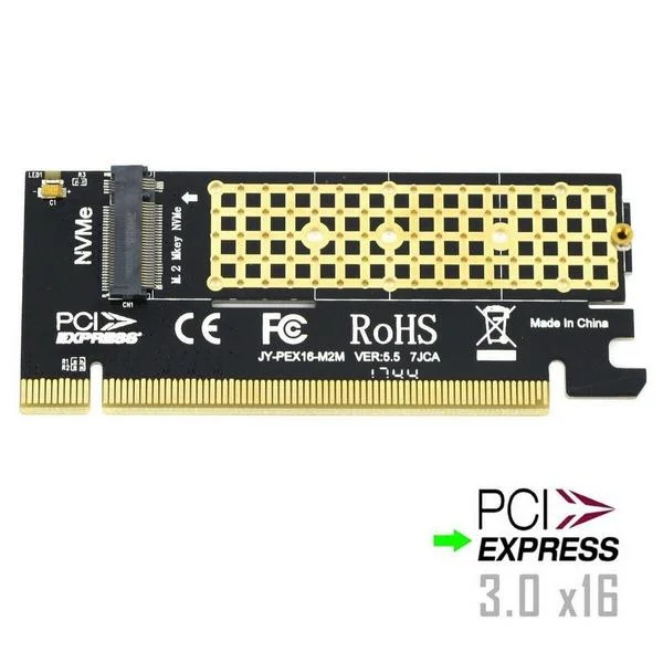

My X16 riser card for the NVME came today. I'll bung that in later with the 256gb drive and move Windows over to that. I've not been taking pics because it hasn't changed much (apart from the fact it's bang tidy) and I can only really work on it at night.

The board has 12v RGB and argb thankfully, so no more money etc.

used those frames on silent wings... such a good idea at the time. specially if you've invested heavily on expensive non argb fans and want a glow not a light show
I used cheapo frames on my silentwings and yeah, it looks awesome. I love the way the ribs catch the lights.
It's more expensive, but man it's worth it. They'll work on any fan too. Plus when you turn them off you are left with a nice black fan. Most RGB fans are white or milky.
I got that done last night. It took about twenty seconds lol. That's what you get for having a three day HL2 marathon ffs. Any way, as I said no rush. I was rather pleased though. Mainly because the one in there already is upside down which is annoying my OCD. I don't want to try and remove the cooler, as they weren't cheap so I will have to live with the annoyance. However, I got my bonus from the fact that the board is upside down, so usually you would see the underside of the riser and nothing else. Not only will you see the drive, but the logo is also the correct way around :D

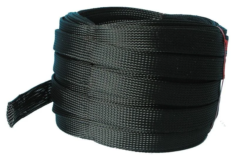

Tonight I will be practising the art of turning the brightness down lol. Got the braid for the USB cable today, but not the other supplies. I did fit the 256gb SSD last night, and it worked fine. GPU has remained at X16 too which is awesome.

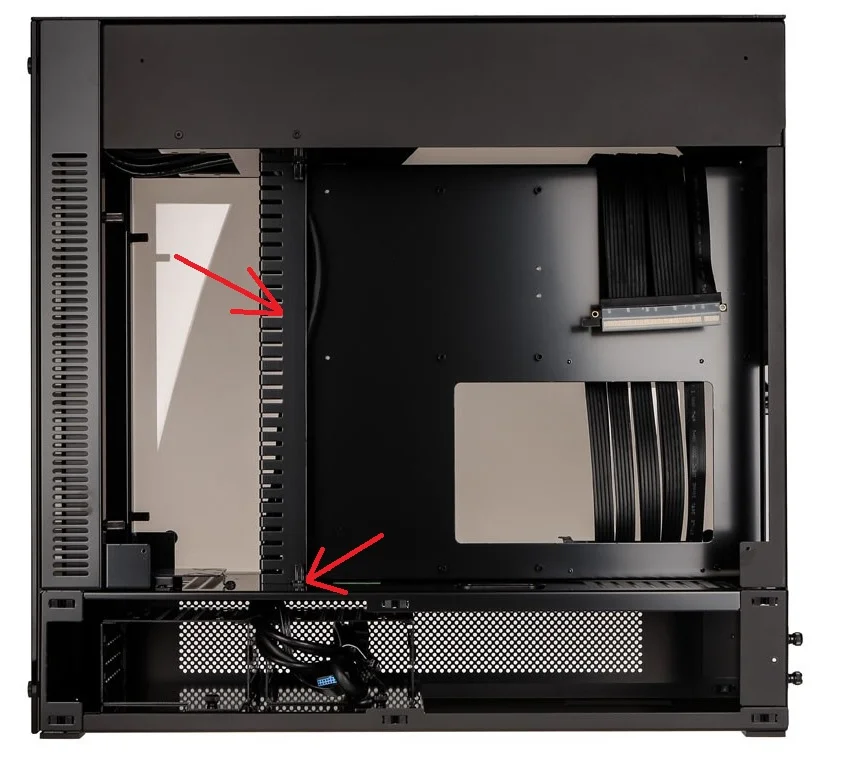

I also realised that a certain part of the case is removable, so I took it off and sorted out the cables.
So out it came, and it has a load of holes to tie the cables to. Can't believe I didn't notice that before. I'm contemplating running the GPU cables into it and down, but I don't know if they will all fit in there. Something for next time I have it all apart perhaps.
