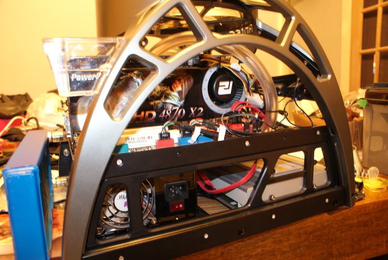

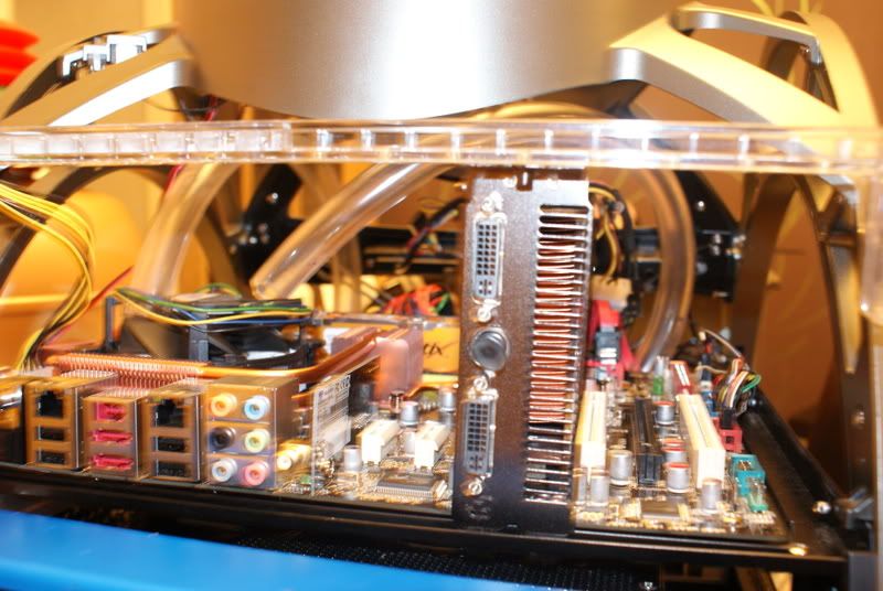

okey dokey, first rough go shows that a rad would fit above the dvd drive but would struggle to any fans in there, maybe one at the back but airflow is going to be restricted. will need to move the psu round although that would make sense anyway, why is it side mounted with the option to move 1" toward the hard drive? add to that the long loop going over the board then back again, it does make an easier fit for a res top pump though.
not sure if the tubing will melt being so close to the exhaust of the x2!

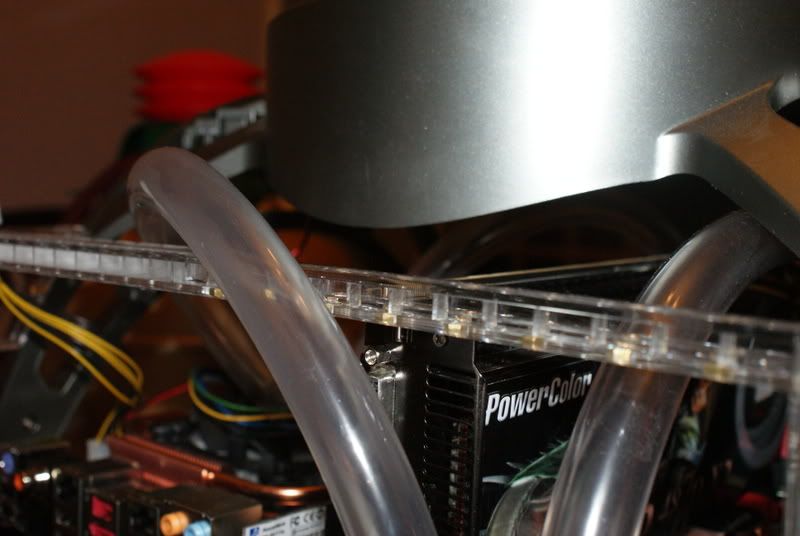

next is the winner (i think), plenty of room at the back for double fans or/and even a triple rad. should be able to make a bracket to fit onto the case, only real issue is squeezing the pump in. a res top will not be easy to fill so maybe a port instead? the good news is that the loop could slide out with the rest of the tray.
ideas (no, not buy a better case!) always welcome please:D
It looks to me like the only realistic way to implement decent water cooling with this case is to have a separate rad/pump/rez box, perhaps have the case sat on top with tubes passing through the rad box roof. Make it all in perpex and it could look in keeping with the thing. Routing the tubes such that they don't bugger up the sliding mobo functionality without ridiculous tube slack will be the difficult thing.
quick update, a bulgin switch fits just about perfect in place of the boring power switch on this case.plus it is loads longer, the old one has cables too short to hide. didnt bother posting a pic, just imagine a bulgin switch with a green light on the case!
