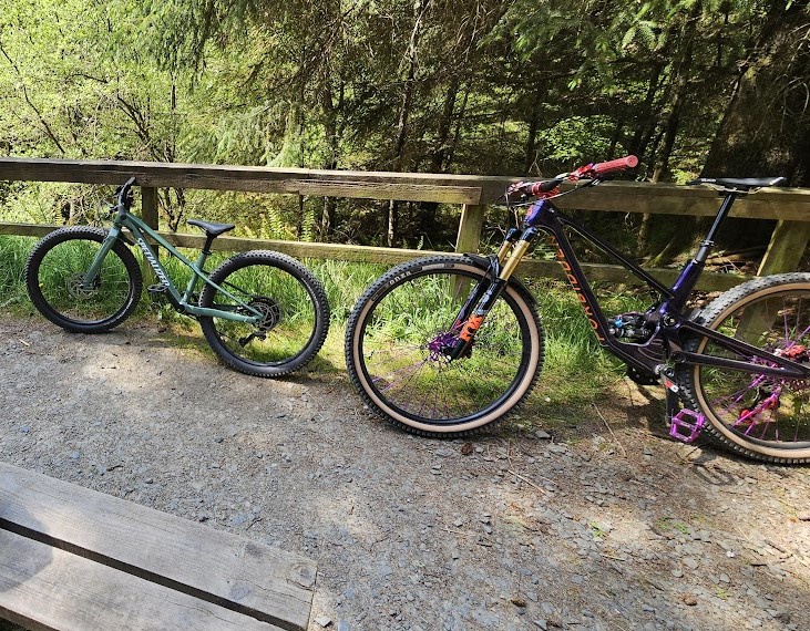

Long wait is over. Can't wait until Friday now.
New PRs around Philips Park on the first ride as well so really happy with that.
Can't wait to get somewhere more demanding.

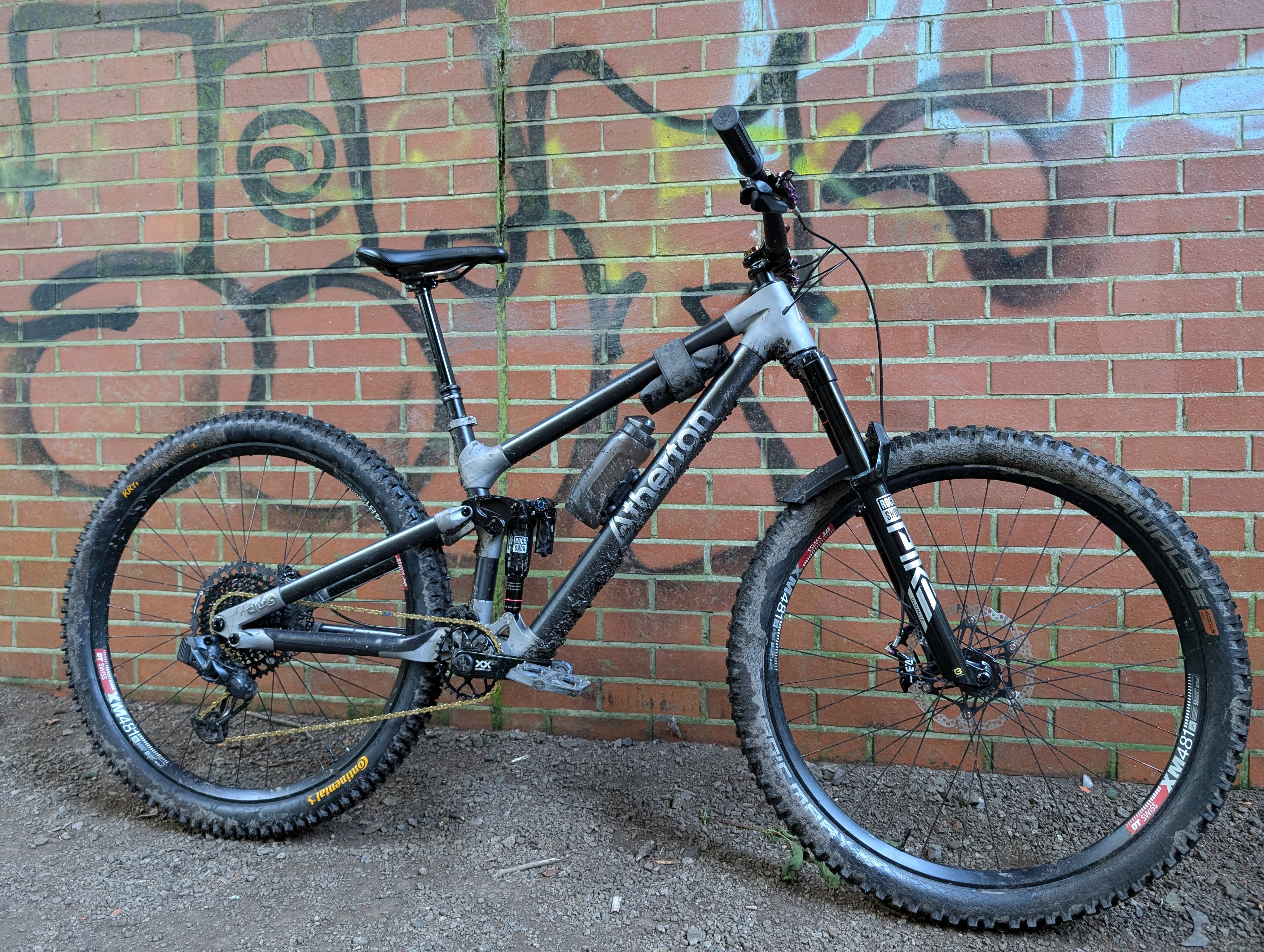

What a lovely build! How you finding the cable free gearing? (I know, I could have asked about the Atherton but then I’d get jealous)…
