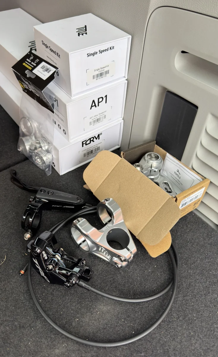

Looks like the Status is getting a single speed make over :D
