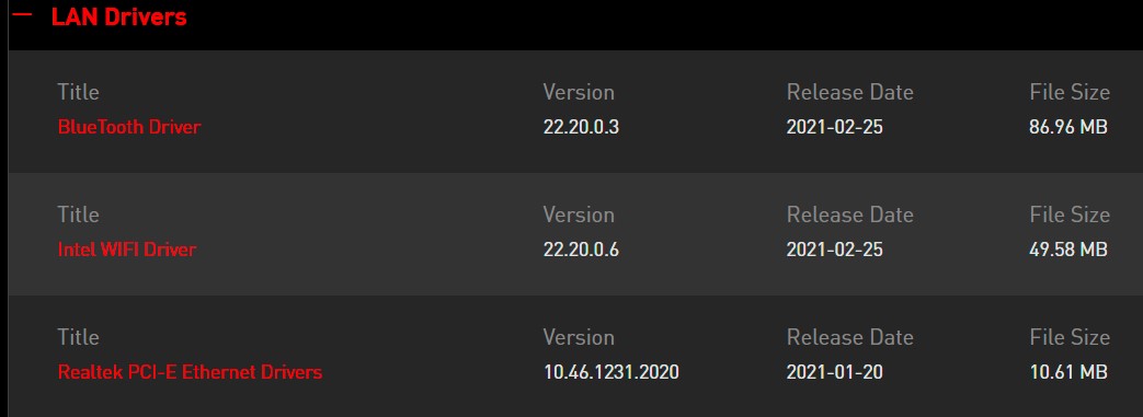

New drivers posted on the support page for Bluetooth and Wifi somehow are older versions than the ones before:
BlueTooth Driver
22.10.0.2
2021-02-23
Intel WIFI Driver
22.10.0.7
2021-02-23
For both those drivers, the previous zip files contained 22.20.x versions.

What's the point of this? Are they saying that the older drivers are better, more stable and should be installed?
now showing drivers from 25th
