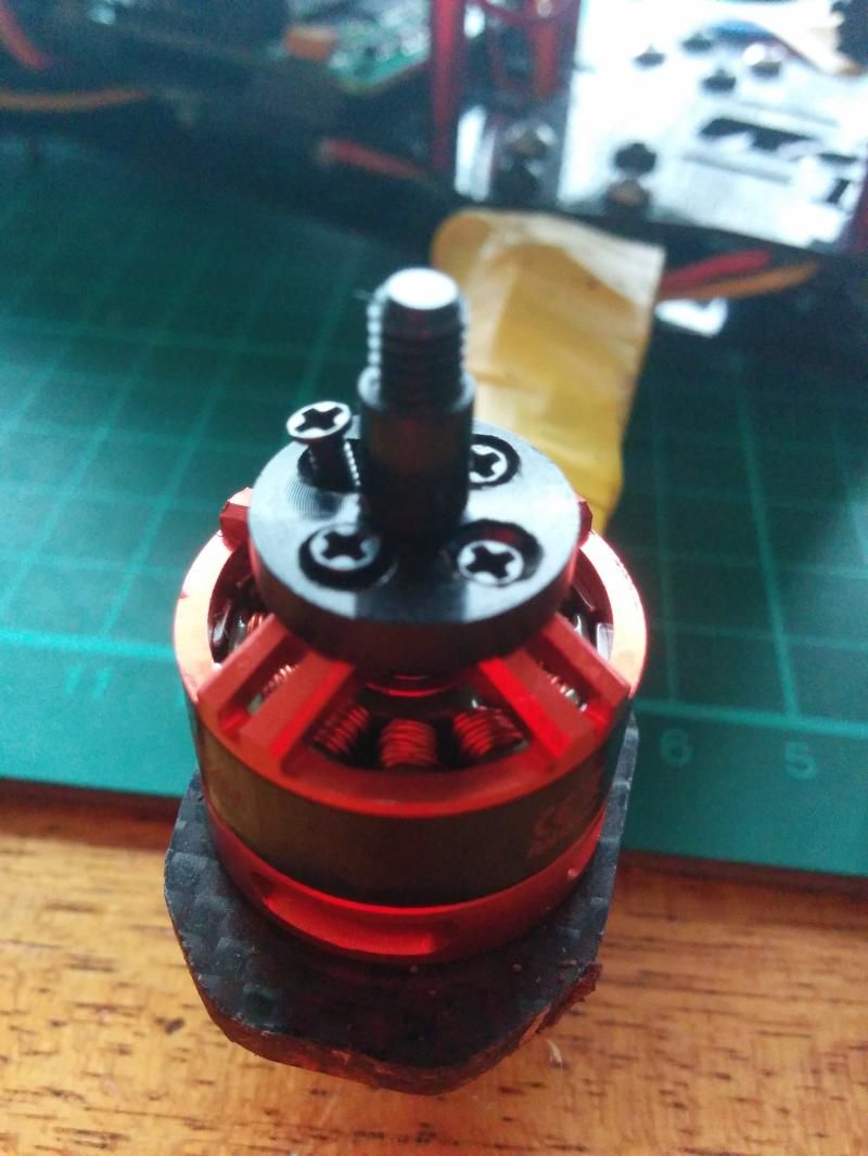

What's the easiest way to test if a motor is bent or unhealthy? My quads juddering and stuttering about like it does when I damage a prop, but it's not the props as I've changed them :(. They are the DYS 1806s. I think my failed flips and rolls and a run in with a flower bed have nerfed something...
Edit: Erm... lol
It's still not perfect but its much better after tightening all those screws on all motors.
One thing you may also wish to consider is balancing your props ... even brand new ones can be off balance and that alone when multiplied by 4 (or in my case 6!) can make for lots of vibrations in the craft - which could have led in part to the screws coming undone on your motors like that photo suggests!
