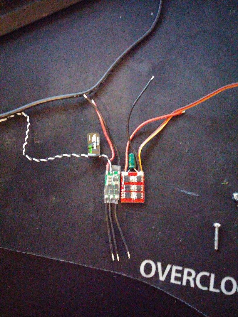

Look what the DHL man dropped off for me today :D that is a emax 12a esc out of its heatshrink next to the beasty 20a oneshot125 and active breaking enabled rctimer esc.
Cant wait for the rest of the parts!
