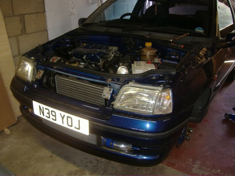

Very nice engine - however, I doubt it would pass 250 BHP. Would be interested what it does though.

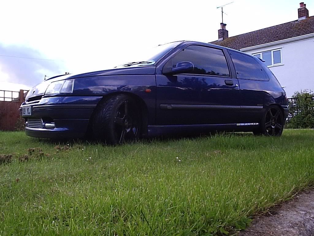

hi. do i still need the hovis photos now then. i agree it doesn,t look at all the same but it is a maxi kit. i have realised the front splitter was a mistake and removed it. also removed the vent as i have fitted a carbon bonnet. i like the skirt and rear spoiler still. the shut lines have been sorted with a bit of adjustment. those photos are from its return from the body shop over two years ago.
bb tuning have run 320bhp with out cams headwork relocated filters 8000rpm rev limit. but i will be happy with what see makes. if i,m not i will upgrade to a t3 as the engines good for it. cheers for all the comments good or bad.
cheers neil
as i said cams and headwork wont add to the power if the turbo cant supply the air a t28 wont push enough CFM of air for much over 300bhp (this is probably the limiting factor on bb's 320bhp as its about the max limit a t28 can push) yu will have to check compressor flow charts to confirm but i cant see it pushing much more.
turbos are a wierd science in the sense that people always seem to go on psi yet its actually cfm which counts.a t34 at 10 psi could be supplying the engine with as much air as a t25 at 25 psi yes the pressure isnt in the system but what counts is when the inlet valve is open how much air is being pushed into the combustion chamber not what the pressure in the inlet manifold is :P
and also depends on what cams you have got you could've caused yourself more problems and make the engine worse, high lift long duration cams are bad for turbos as the valve overlap will just throw the boost out the exhaust.
relocated filters wont really make any difference at all to power so no point listing it! and rev limit being 8000rpm will only be any good if the turbo can keep torque up to that rpm otherwise soon as torque falls your peak power falls and it makes your high rev limit pointless.
engine build is nice i agree but in all honesty you do need a bigger turbo if thats the figure you want, a t34 would be ideal for your application although this will require a new turbo flang on your manifold and new oil lines etc ans t3's are quite a bit different in this area.
if have a set of custom made high lift short duration cams.
so a filter thats sat behind the radiator drawing warm air will produced the same power as one drawing cool air
yep pretty much once it hits your compressor thats boosting intake temps to 60 deg before charge cooler
CAI have no where near as much influence on turbo cars as n/a due to your main source of air temp iss the turbo not the intake.
also i wouldnt of used a charge cooler FMIC's are far more efficiant and much better at cooling air, charge coolers are awesome for short stages where you can load them up with ice but the fact you have 2x heat transfers going on makes them much less effeciant than a decent fmic setup.
