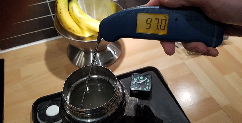

I will retest the sigg and tkpro because of the starting temperature.
I did a stupid newbie mistake, with the ThermoPro TP02S i did not remove the cover so that explains the starting temperature of 93c and 97c.
The only ones i would trust is the ones i am testing in the freezer, so i apologise.

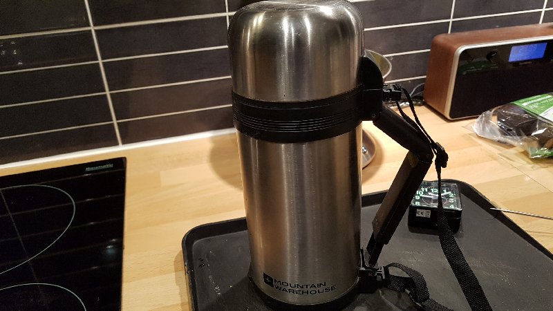

I just dug my 1.2L flask out, fully filled with boiling water to preheat it, then emptied and filled with boiling water again. Ill see what temp I've got at 3.10am, I'll probably still be up. :p Only £15, not expecting amazing temperature maintenance but its certainly kept my water hot enough for a few hours when I've used it.

This has ultimately backed me up about the 97c starting temperature, thank you, nice to see my cheapo thermometer gave the same exact reading there...

Well I missed my 6 and 12 hour deadlines and will do the test again on Friday.
Instead of checking after 6 hours at 3.10am, it was 7.5 hours later at 4.40am before I got back to the flask which gave me 79c. Then I got back to it again at 9.40am which was 12.5 hours since the start and showing 70c. So when I get temps at exactly 6 and 12 hours I anticipate about 82/3c and 71/2c.
The water still felt very hot to the touch at 9.40am, and it looks like a cheap flask like mine is keeping similar temps to between the Stanley and the Ultimate flask.

Well my results are in. Not too shabby for a cheap double walled flask. Interesting how it lost 15c in the first 6 hours and only 10c in the final 6 hours. AndyCr15, would you be so kind as to publish my data into the spreadsheet. Thanks. :)
Product: Mountain Warehouse Food Flask
Price: £14.99
Link:
https://www.amazon.co.uk/Mountain-W...ehouse+flask&qid=1579888650&s=clothing&sr=8-7
Tested By: Merlin5
Pre-Warmed: Yes
Starting: 98c
6hrs: 83c
12hrs: 73c
Thermometer Used: Thermapen 4 Pro
Conditions: Room temperature (17-20c)
