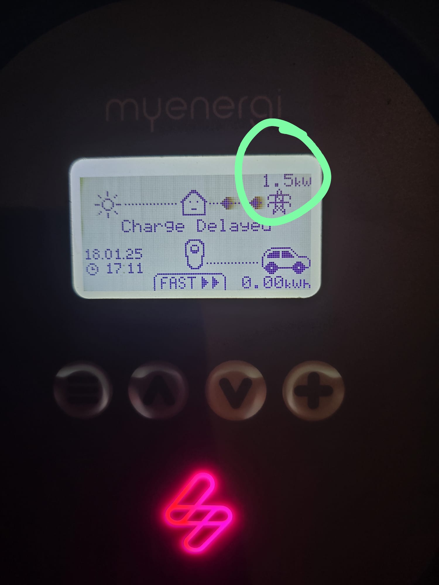

EV Charger is a Zappi, I isolated this from the circuit breaker last night and it didn't drop the power usage on the IHD so don't think it's that.

Zappi reports its CT readings in real time on its screen. Does your Zappi have a CT connected and is this wrapped around your main tails somewhere?
Does the grid reading on the Zappi agree with your smart meter IHD (within a few % margin of error)?

Ok so here's a potentially interesting update following your suggestions @dlockers and @b0rn2sk8 especially.
I had another look at the Zappi charger. Turns out as you say, it's somehow connected to the mains and it displays the current power draw of the property, and seems to mirror my IHD pretty accurately. Which means I don't need to isolate circuits inside the house, I can do it from the mains boards in the basement next to where my smart meter is.

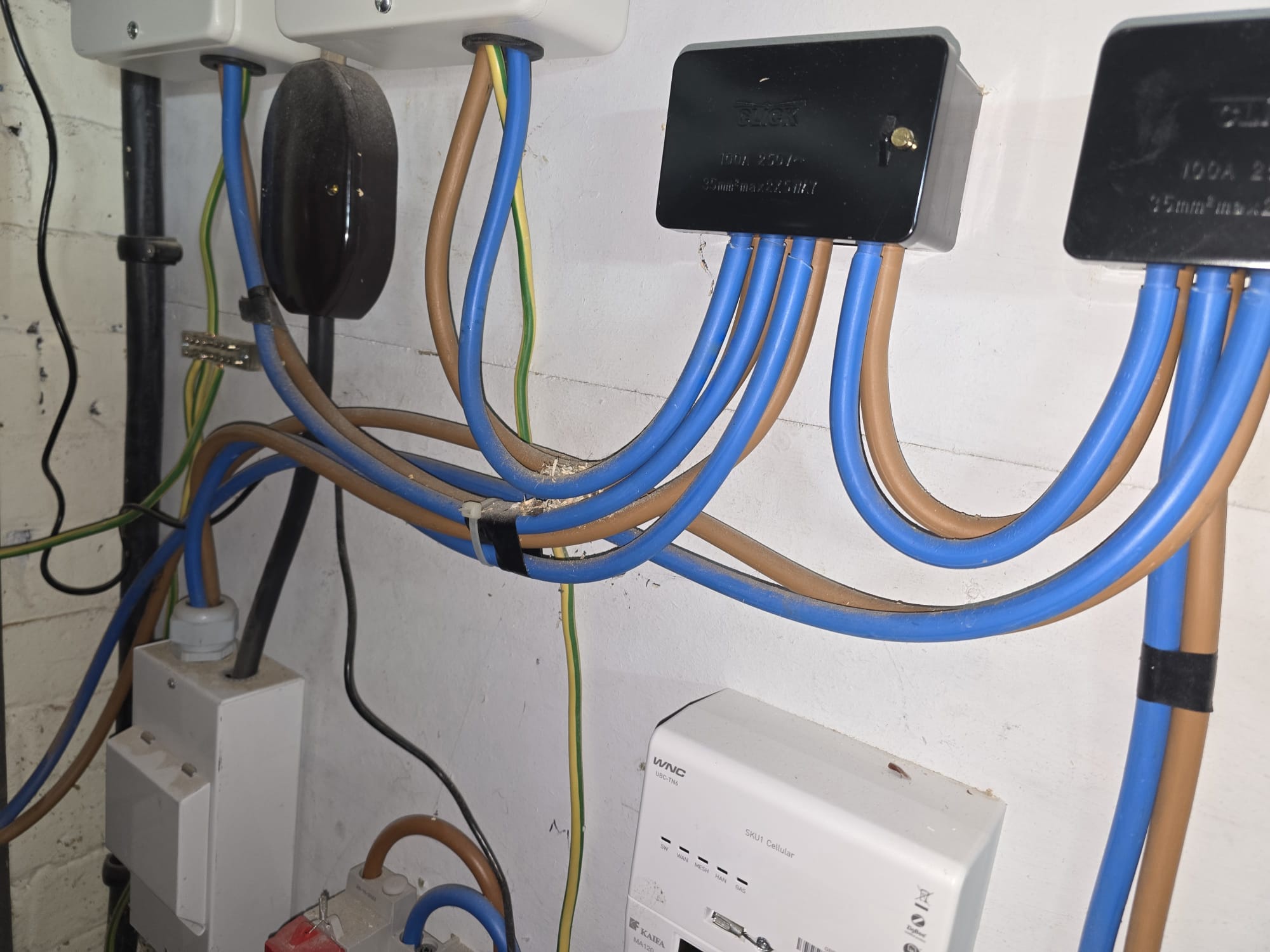

These are the mains circuit breakers that supply everything in the property. They're right next to my smart meter. I had a look at the meter, it shows my usage in kWh but that would mean having to turn everything off and wait an hour to see if it goes up by 1kW which isn't practical.
So I did the next best thing, I found the small breaker that supplies the Zappi and the Zappi only, left that on, and turned every other breaker off from the mains for the entire property.
Lo and Behold, the Zappi displayed 0.0kW for the first time.
Turning breakers on one at a time, starting with the far left on the picture above, the Zappi went to 0.4kW. The second one then turned most things in the house back on it seems, as Zappi went back to 1.1kW which is my standard baseline where it then remained.
So I guess that rules out a fault with the smart meter since it went to 0.0kW? And it means there's something dodgy on the property itself?
Did you not do the individual breakers in your consumer unit before?
So I've got these breakers in the basement next to the smart meter.
I've got 2 sets of breakers in the main part of the house inside that supply all the rooms.
I've got a breaker in the pool room, and a breaker in the garage.
The latter 4 sets of breakers is what I turned off last night, thinking that covered everything inside the house and property. But clearly that resulted in that ~660W still going. Doing it from the breakers next to the meter got me to 0.0kW. I'm not sure why there's a discrepancy there.

There is no problem with your meter, it’s correct if it agreed with the Zappi. You are using the electricity somewhere, it’s up to you to find what it is, bear in mind, there may be multiple things.

But those two main breakers are just a single switches, and I don't know exactly what it supplies since it's down in the basement.
The cabling is a bit confusing, I can't make head or tails of what goes where.
Is none of it labeled?
It’s basically process of elimination I’m afraid. Working though it all circuit by circuit, mapping out what is going where and powering what. Labelling it all up and it will make much more sense.

Unfortunately not! Will try and figure it out.
I've seen worse, those black boxes are just junction boxes for meter tails, normally referred to as 'Henley Blocks' so you can connect more than one distribution board. It It is the individual circuits in the distribution boards should all be labelled.
