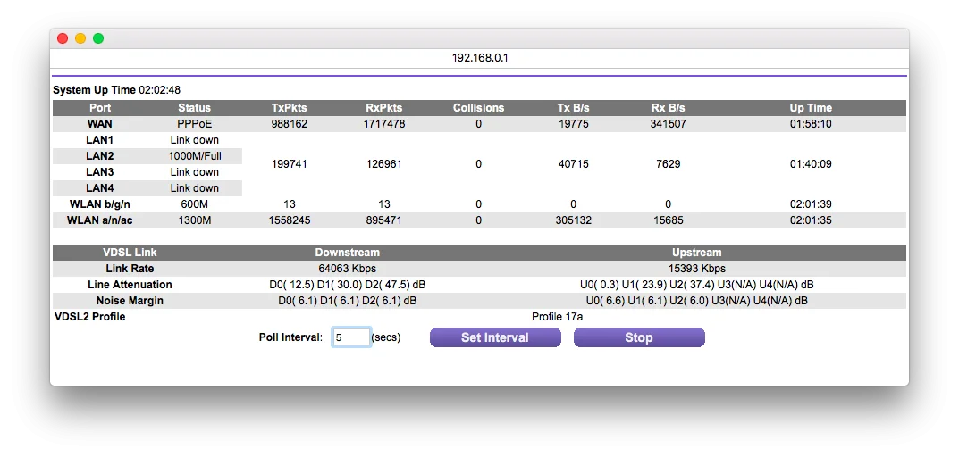

Here's some basic router stats after an a couple hours up. Will telnet tomorrow some time. Not entirely sure what i'm looking for! :p
There isn't really much info there apart from your down/up speeds along with SNR and line power. Best to get the stats from the telnet.

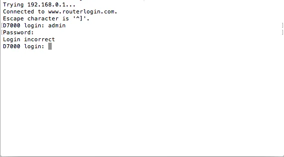

Tried logging into telnet on Mac via Terminal and greeted with;
I'm logging in with the default UN and PW.

Max:    Upstream rate = 15441 Kbps, Downstream rate = 60734 Kbps
Bearer: 0, Upstream rate = 15393 Kbps, Downstream rate = 64063 Kbps
Link Power State:       L0
Mode:                   VDSL2 Annex B
VDSL2 Profile:          Profile 17a
TPS-TC:                 PTM Mode(0x0)
Trellis:                U:ON /D:ON
Line Status:            No Defect
Training Status:        Showtime
                Down            Up
SNR (dB):        4.7             6.1
Attn(dB):        17.8            0.0
Pwr(dBm):        13.4            6.8
                        VDSL2 framing
                        Bearer 0
MSGc:           18              14
B:              239             238
M:              1               1
T:              21              14
R:              0               16
S:              0.1192          0.4942
L:              16104           4128
D:              1               1
I:              240             255
N:              240             255
                        Counters
                        Bearer 0
OHF:            89989574                269874
OHFErr:         13206           4
RS:             0               2964680
RSCorr:         0               88
RSUnCorr:       0               0
                        Bearer 0
HEC:            24602           0
OCD:            167             0
LCD:            167             0
Total Cells:    3719832075              0
Data Cells:     137363851               0
Drop Cells:     277
Bit Errors:     0               0
ES:             2139            4
SES:            14              0
UAS:            28              28
AS:             169639
                        Bearer 0
INP:            0.00            0.00
INPRein:        0.00            0.00
delay:          0               0
PER:            1.88            6.94
OR:             101.84          23.03
AgR:            64165.35        15415.73
Bitswap:        50296/56196             34/36
Total time = 1 days 23 hours 7 min 47 sec
FEC:            0               88
CRC:            13206           4
ES:             2139            4
SES:            14              0
UAS:            28              28
LOS:            0               0
LOF:            0               0
LOM:            0               0
Retr:           0
Latest 15 minutes time = 7 min 47 sec
FEC:            0               0
CRC:            10              0
ES:             6               0
SES:            0               0
UAS:            0               0
LOS:            0               0
LOF:            0               0
LOM:            0               0
Retr:           0
Previous 15 minutes time = 15 min 0 sec
FEC:            0               0
CRC:            16              0
ES:             11              0
SES:            0               0
UAS:            0               0
LOS:            0               0
LOF:            0               0
LOM:            0               0
Retr:           N/A
Latest 1 day time = 23 hours 7 min 47 sec
FEC:            0               33
CRC:            6534            3
ES:             1058            3
SES:            8               0
UAS:            0               0
LOS:            0               0
LOF:            0               0
LOM:            0               0
Retr:           0
Previous 1 day time = 24 hours 0 sec
FEC:            0               55
CRC:            6672            1
ES:             1081            1
SES:            6               0
UAS:            28              28
LOS:            0               0
LOF:            0               0
LOM:            0               0
Retr:           0
Since Link time = 1 days 23 hours 7 min 19 sec
FEC:            0               88
CRC:            13206           4
ES:             2139            4
SES:            14              0
UAS:            0               0
LOS:            0               0
LOF:            0               0
LOM:            0               0
Retr:           0
NTR: mipsCntAtNtr=0 ncoCntAtNtr=0
