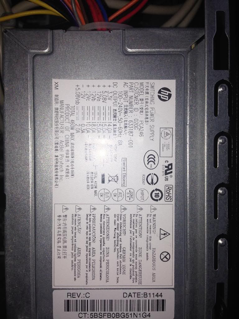

Just opened up my case and checked the power supply. It says 415w maximum, I'm thinking of upgrading to the 550w. Would that be necessary? In terms of room, there seems to be plenty although I'm not exactly sure what I'm looking for. I could take pictures and post them if it'll be easier to determine for you?

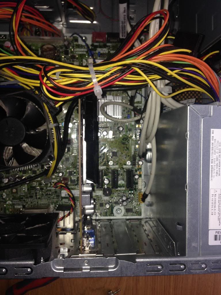

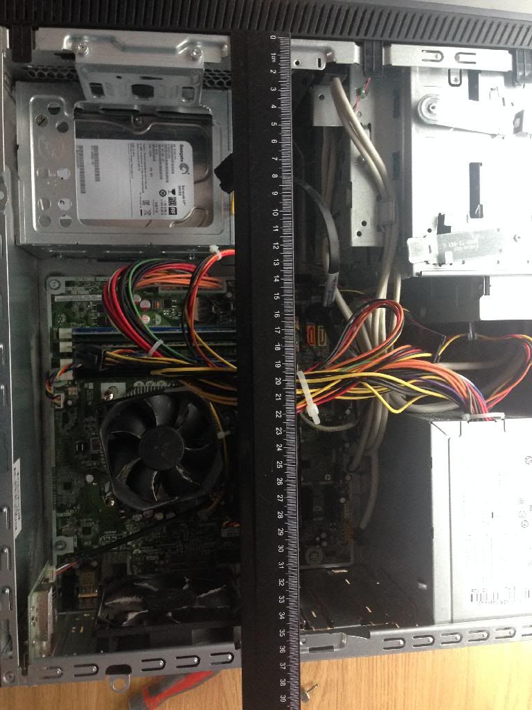

On taking measurements I realise I may be limited with space. What would my options be in that case? A smaller card? Or would I be able to purchase a new case? Or would I be able to fit a card like the ones you suggested?
yeah might have trouble fiting a new card in that case the radeon r9 270 can be 20-26cm long depending on the cooler, you might fit one of the 20cm r9 270s in...just, judging by your picture. the one that is 20cm was one made by powercolor though the exact model doesn't appear to be on ocuk. The dimensions aren't always listed so you might have to surf a few review sites to find a 20cm one you can get hold of.
I'm not sure id trust a psu made by acbel like the one you have judging by some of the reviews i just read, as said a bad psu can blow and take your components with it. so yeah i guess you need shortest r9 270 you can find, that 550w superflower psu someone linked and maybe a new case if the card you get still doesn't fit or you want a longer gpu, either way i think you'll be going over budget.

2nd edit.. looking at the pic again you might be able to fit a longer card as long as your hard drive bays dont get in the way...
