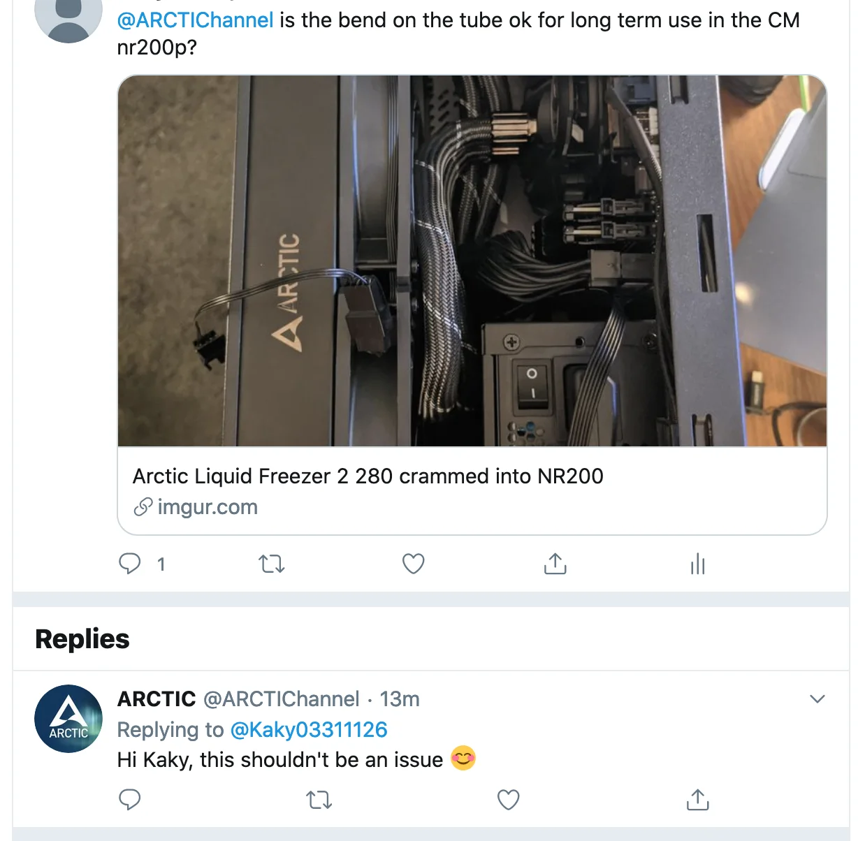

so the NR200 officialy support the Arctic liquid freezer II 280.
Question or statement? If it's a statement, where do you see this? Or have you done it yourself?
Also how is it mounted? GPU vertical or horizontal? So basically, is the Arctic freezer side mounted or bottom mounted?

The picture I saw earlier in the topic was a vertical GPU with bottom mounted 240 version, so I'm really curious now.
I think it's about this one:
https://imgur.com/a/q8JV2Vy
Not sure I would bend that tube like that btw
That looks dicey :eek:
If you already own a Freezer II, I guess it's worth a go. It'll probably be fine. But buying one specifically for this case just seems daft. An extra £20-£30 will buy a similarly performing AIO that actually fits. Or you can spend the same money and see CPU temps rise by a few degrees. To me, either of those options seems preferable to putting the fittings under strain.

It does look a bit tight indeed. I dont own one yet, I have a Corsair H100i RGB PLATINUM, which is 240mm and it has the tubes on the side), but I was hoping to re-use that for something else.

i think the tubes are fine, since the tube housing on the arctic is so thick and contain the pwm splitter, the real tubes are not that bent. Guess we have to ask arctic for that.

Got a response from arctic, regarding the tube bending in the case
