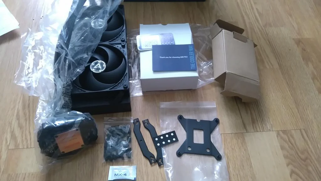

Well I got the Liquid freezer II 240 REV 2 delivered £52
All parts seem to be there & look in new condition
+ 3 x Haribo :D
