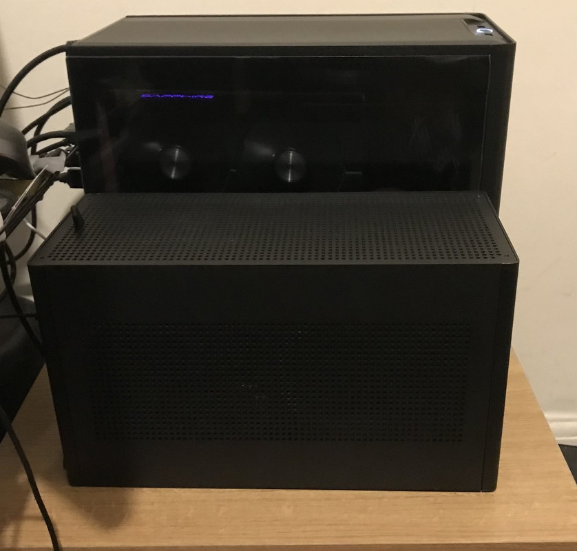

Needed a bigger case for a pending 30 series. Was a bit shocked by the size difference.

How are your GPU temps running the vertical orientation and the TG? Yeah if I didnt know any better I'd think you were comparing a ITX to a mATX/ATX case haha.
They might aswell make it an MATX tbh, I used to have a Rajiintek Styx Matx and it's pretty similar in size.
In case anyone was wondering, the Fuma 2 is not compatible with the Asrock Z390 phantom gaming ITX. The heatpipes of the cooler interfere with the VRM heatsink.
I'm planning the same move but that looks WAY bigger than I expected!
