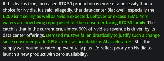

apparently in a month there is going to be an excess of stock?
Here's a snip from that page...
I wonder what combination of that is Nvidia over-estimating datacentre demand and companies like DeepSeek demonstrating that you don't need anywhere near as much hardware as Meta, OpenAI etc have purchased in order to produce models LLMs that are superior. With the second half of that equation, companies like Microsoft, Amazon etc would have all cut back their orders of Nvidia's datacentre solutions and so we get this apparent repurposing.
