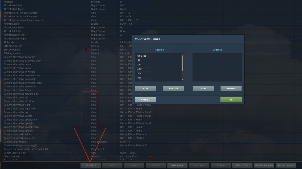

Another tip, when you are running short of buttons on your HOTAS (which one is it btw?), you should assign one the hotas buttons as a "Modifier" in dcs. This effectively doubles (triples if you have two modifiers etc) the number of buttons on your hotas. E.g. you have flaps assigned to button1 and modifer to button2 on your hotas. You can assign speedbrake to button1 + button2.
I have a "Thrustmaster T-Flight HOTAS X" at least that's what is says on the bottom :)
Ah yes.. modifiers.. I shall have to investigate these..
