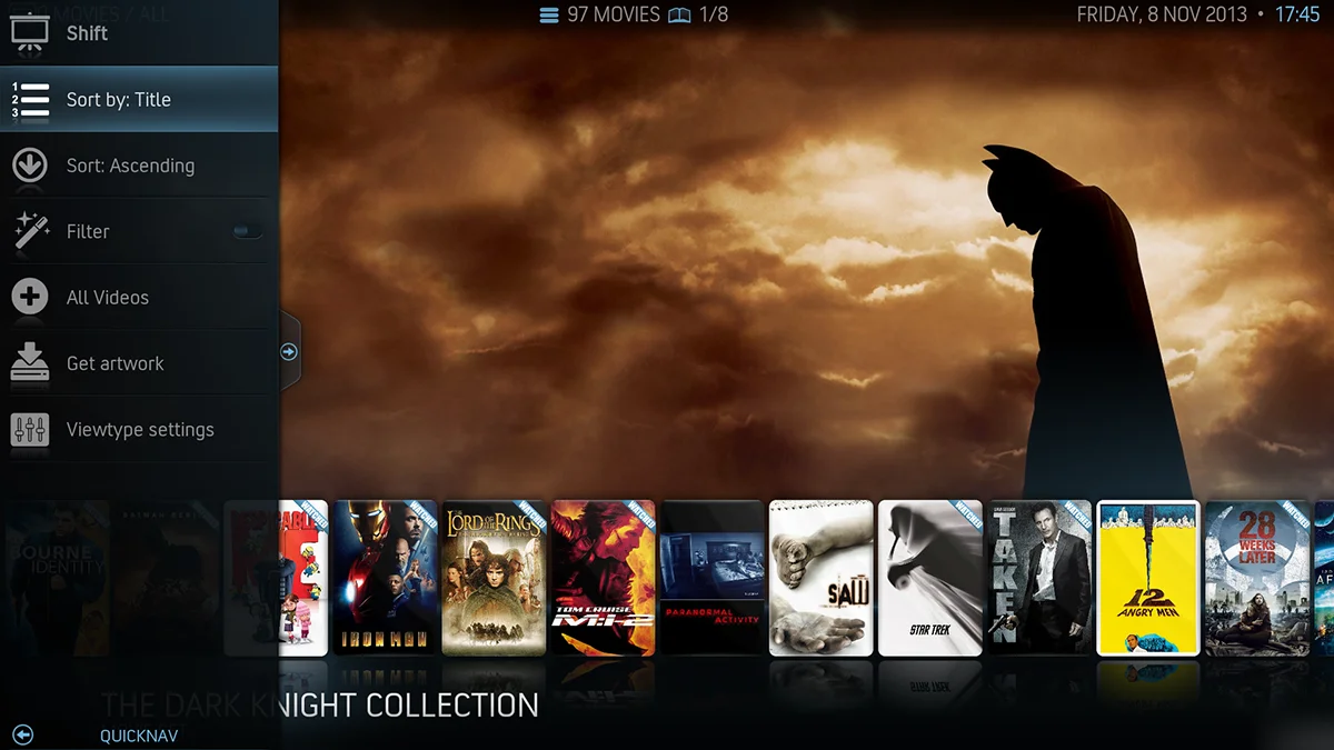

Anyone have any ideas why the groups appear first and how to make them appear in alphabetical order?
You must have a setting to "flatten" them if part of a collection, look in video/library settings
